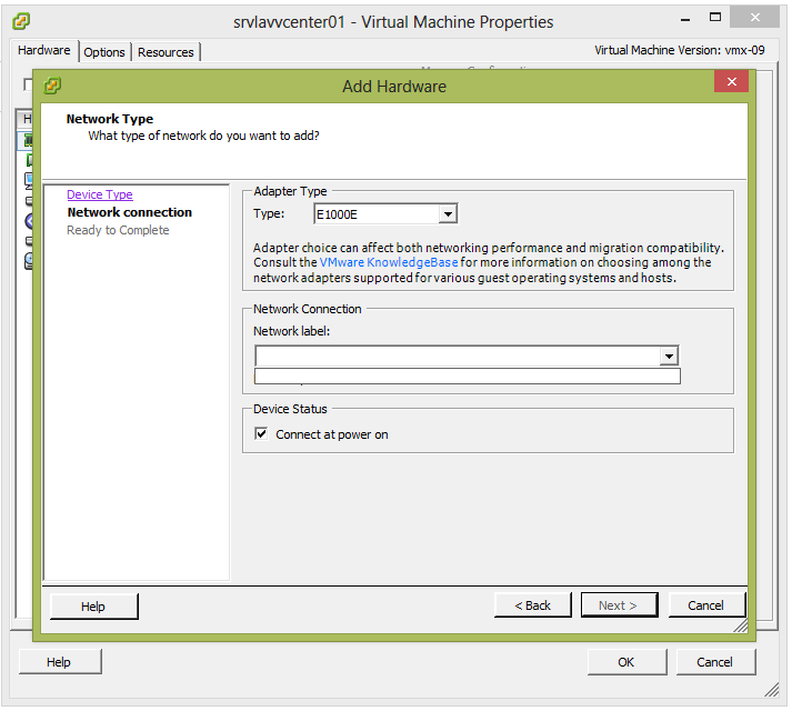

    I have removed the NIC from my vcenter server because I was having some network issues with that server, now when I try to add a new one the network label drop down is blank? I am using 5.1 with vDS. I am logged into the host and everything looks ok. suggestions?

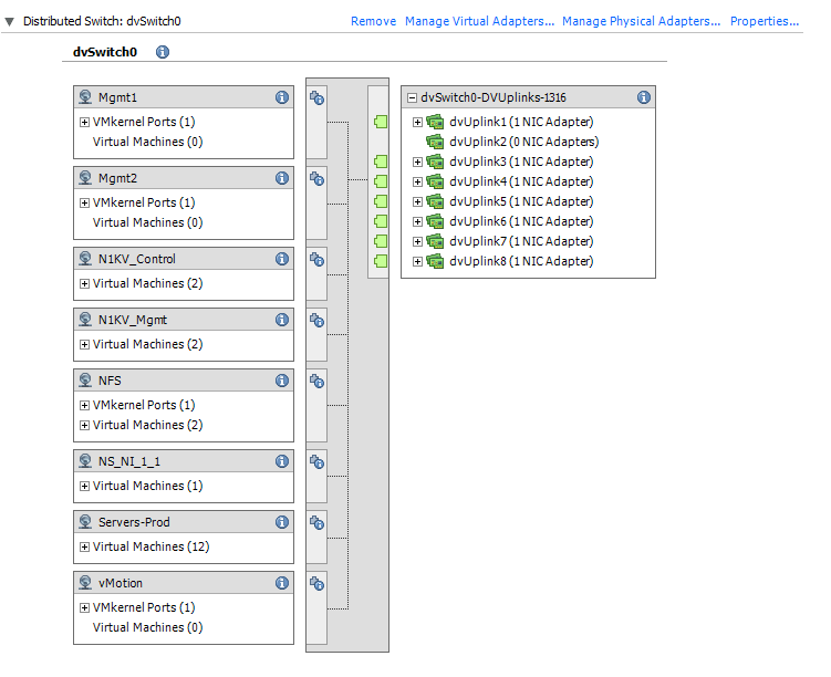

    Can you tell us about the networking setup?  (i.e. how many NICs and how they are assigned).  Perhaps a screenshot from the networking page might help if in doubt.
    Basically what we will have you do is "steal" a NIC from the bundle that makes up the guest network.  Then add that NIC to a vStandard Switch (may need to add the VLAN ID if you use 802.1q tagging).  Then you can flip the vCenter VM (from Edit Settings) over to the temporary port group you create on the VSS.  Once your VC starts pinging again, you can just flip the vNIC back to the appropriate DVS portgroup (no additional reboot required).  Then flip the VSS pNIC back to the DVS.

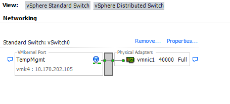

    My mgmt network on the vDS had two NICs, so I removed one from the vDS and then created a new vkernal port in the vSS. Gave the kernel and IP address, I have verified that I can ping the address. So then I went into the settings of my vcenter server, added a NIC and still the network label drop down is blank.

    You don't have to create a vmkernel port group. The nic that you removed from the management, use it to create a virtual machine port group on a new VSS. The right click on your vCenter server and edit settings. Go to network adapter and from the drop down, select the new VM Port Group that you created. Your vCenter will be back on the network. After that you can edit it again and set it to the original port group on your vDS and add the pNIC back to the management network.

    I agree with asrarguna that this should be a VM only network (not vmkernel, so don't check the box).  My recommendation was to take a NIC from the current bundle that makes up the VM guest network (as opposed to mgmt.).  Removing/re-adding ESXi host management NICs could cause a blip on the host (i.e. false isolation event).  Since you are moving around what seems to be a mgmt. NIC, you might consider unchecking the "Enable Host Monitoring" setting on the cluster while working on this issue.  To do so, right-click the cluster, then navigate to Edit Settings > vSphere HA > Enable Host Monitoring, then uncheck the box for "Enable Host Monitoring".  Failure to do so may cause an HA event.
    Also, you should consider using the vmxnet3 adapter.  Anything else is a risk (there are known issues with the e1000 and e1000e).  Looking at the screenshot, I see all vNICs have been removed from this VM and you are adding a new vNIC.  Make it vmxnet3 and log in locally to set the IP address on this vCenter VM.  Once connected and pingable, flip it back to the proper DVS port group.
