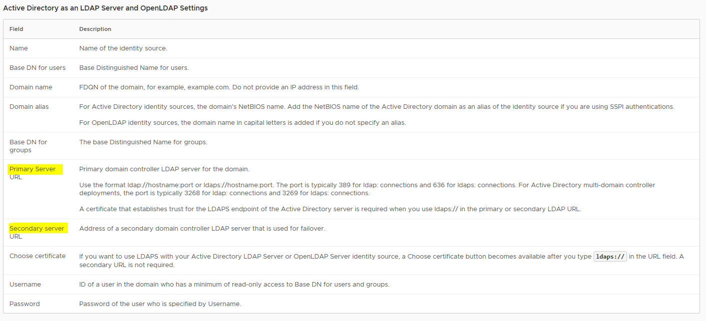

    So you can only have a max of two domain controllers for ldap authentication?

    If you join the VCSA to the AD domain, why you should be worried about the number of DCs? you will need to mention only the Domain Name and it will handle your authentication request by any available DC. But if you want to add the AD as an LDAP server, you can add same alias name for all of your secondary DCs and round-robin will handle your concern about losing more than two DCs in the same time

    You need to configure Identity source in vCenter as mentioned below steps.
    1. Login to the vSphere Web Client as administrator@vsphere.local
    2. From the home location, navigate to >>Administration >>Single Sign-on >>Configuration and select the Identity Sources tab
    3. Click the green + to add an Identity source
    4. In the Identity Source page, select Active Directory as a LDAP Server.
    5. Fill in the Identity Source Settings information for your Active Directory domain
    Name: Label for identification
    Base DN for users: The Distinguished Name (DN) of the starting point for directory server searches. Example: If your domain name is domain.internal the DN for the entire directory is "DC=domain, DC=local".
    Domain name: Your domain name. Example: "domain.local"
    Domain alias: Your netbios name. Example: "XYZ"
    Base DN for groups: The Distinguished Name (DN) of the starting point for directory server searches.
    Primary server URL: AD Server URL. You can either query the local directory (Port 389), or the global catalog (Port 3268). Example: "ldap://snow.domain.local:3268"
    Secondary Server URL: “ldap://rain.domain.local:3268”
    Username: A user in the AD Domain with at least browse privileges. Example XZY\vcadmin
    6. Click Finish.
    7. After clicking Finish, this should add the domain to the list
  • 9.  RE: vCenter - ad authentication with more than 2 domain controllers
    Posted Mar 20, 2020 03:40 PM
    or in short words: you must address the global catalog at port 3268 on two different domain controllers.

    In short, in the case those two configured DCs are unavailable, vCenter authentication will fail for that Identity Source.
