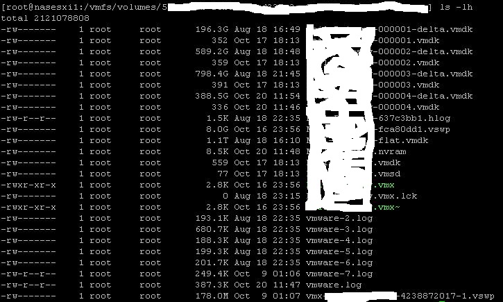

    I have a VM, which is used about 400GB but in the datastore, it shows the VM used 1.98 TB of datastore. Now I want to run consolidation for this VM but there is not enough space to run. I have tried to delete all snapshots but there is no luck because, there's nothing in Snapshot Manager, just only "You are here". Via console of ESXi, it is shown as below:
    How can I solve this issue?

    From the timestamps it would appear that yes, these snapshots are likely part of the currently active disk-chain - this can be verified by looking at the chains parent-child info in each descriptor file and by looking at the .vmx (e.g. #cat VMname.vmx | grep vmdk   or Right-click > Edit Settings > Hard Disk 1/2/etc. > look at the path which will be -000004.vmdk).
    How much space is free on the LUN/datastore that this VM resides on? I ask as if this is full then consolidation may not be possible until you extend the space or free up a little bit (e.g. by powering-off the VM and freeing up the 8GB the .vswp uses).
    If there is free space on the datastore (if not thin then check with #df -h ), then you would likely be able to make a consolidatable reference by removing the current .vmsd (the file that shows snapshot chain in snapshot manager), then taking another snapshot of the VM and then using 'Delete All' snapshots option.

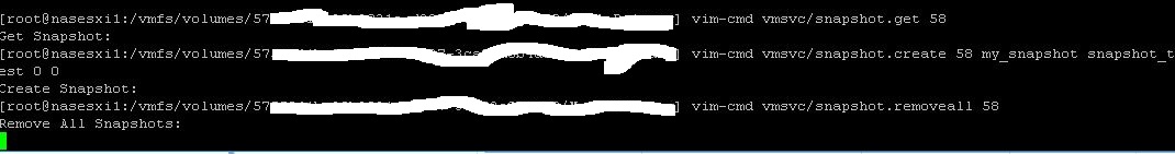

    You are correct, the output is exact as your prediction. I've just created a snapshot and now I'm waiting for the result of command "vim-cmd vmsvc/snapshot.removeall 58" (58 is VMId). It has been idle for an hour as below:

    it does not help. I tried 2 times and now there are 2 new vmdk files as xxxx-000005.vmdk and xxxx-000006.vmdk (before is 000004.vmdk). The thin provision of this VM is bigger after trying this way. Pls help me, tks

    "It has been idle for an hour as below"
    It's not idling it's trying to write the ~2TB of data you appear to have in snapshots.
    "it does not help. I tried 2 times and now there are 2 new vmdk files as xxxx-000005.vmdk and xxxx-000006.vmdk"
    Yes because you took (assumedly more than 1) extra snapshot, the number of snapshots here is unlikely the problem more so the size of the snapshots and likely your storage timing out at some point while trying to write the all the data back to the base-disks - the vmkernel.log and/or vmware.log of the VM should indicate this (or some other cause) for to failing to consolidate the snapshots.
    You *may* potentially have better luck consolidating them with the VM powered off as the IOs of the VM itself can also be a source of contention to the storage that is trying to write-back the snapshots here. If this also fails then potentially cloning the disk with the VM powered off might be your only option but do ensure you have adequate space to perform this.
    Bob
