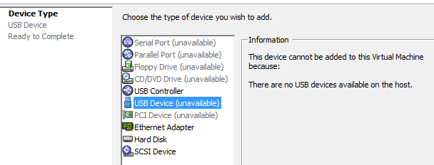

    So, we had a VM that was using an external USB drive for a legacy system (don't ask, I didn't set it up). After I put the host in Maintenance mode, and shut it down to add memory, the USB drive is no longer available for VMs to use.
    It's there in lsiusb, but not available when trying to connect it to the VM.
    usbarbitrator is running

    The device is not available in the VM's "Connect to a USB Device" dropdown either. I think it's the HOST machine that's not processing the device correctly. There's nothing available at the drive's vmhba32:C0:T0:L0 path.
