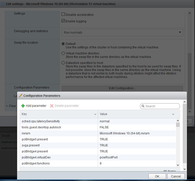

    3. Go the ESXi UI client, edit VM settings, VM Options tab, Advanced, there is a Configuration Parameters with "Edit Configuration" button and use the "Add Parameter" option to add those two lines.
