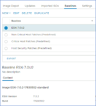

     - could you share what your Upgrade Baseline looks like, and double check the Build/ISO used there? Attached is my reproduction in a lab, and I didn't encounter this.
    is the U1 host or vCenter Server you're using running on a Beta build?

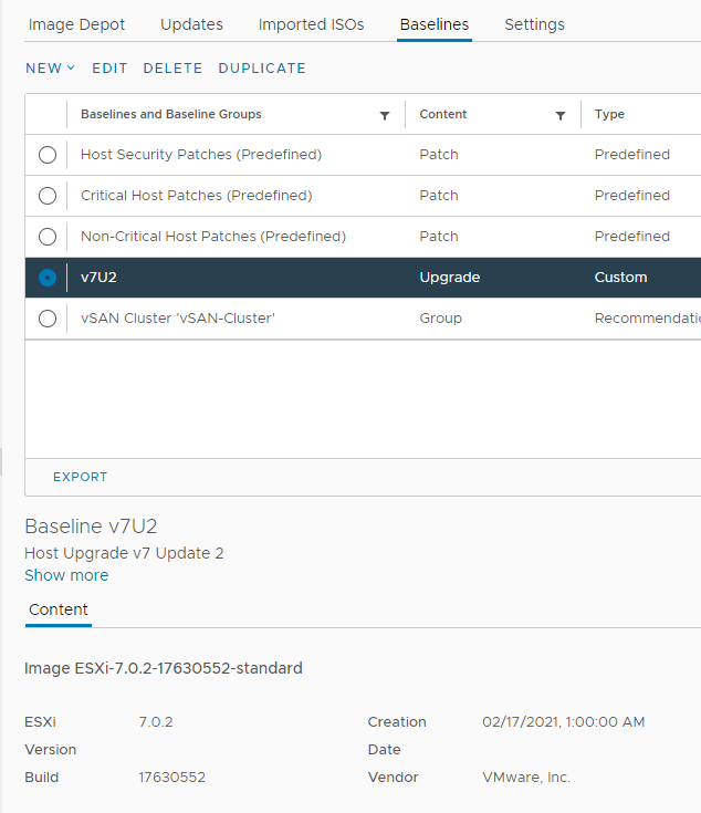

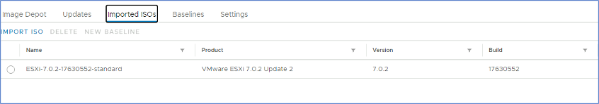

    here's my imported iso and my baseline.
    Build numbers are the same.
    Neither host nor vc were running on beta builds.
