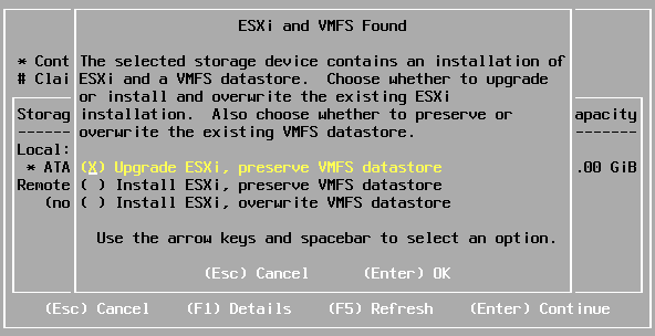

    Hello.
    If you have the ISO image of the manufacturer the easiest way to update would be to  boot the server with this ISO and choose the option Update ESXi, preserve VMFS datastore
    You must be sure that you chose the disk that contains the previous VMware vSphere installation, as it shows all the internal and external disks that you have access to from the host.
