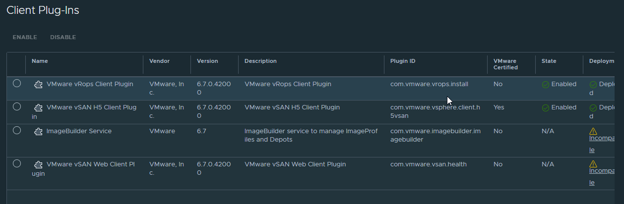

    Can you check the update manager plugin showing in vCenter. Check with following steps.
    1. Login to vCenter via Web Client
    2. Click on Home
    3. Click on Administration
    4. Click on Client Plug-in
  • 5.  RE: Update Manager feature in vCenter missing
    Posted Mar 24, 2020 01:50 PM
    it is not present in that screen.

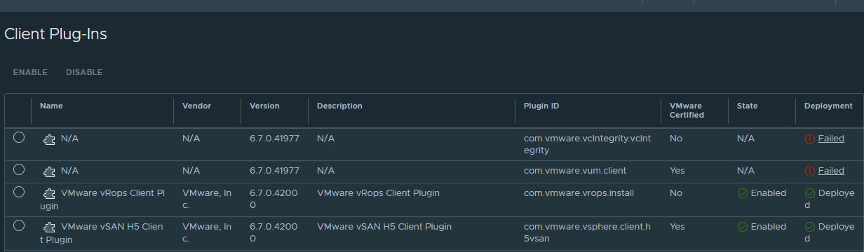

  • 8.  RE: Update Manager feature in vCenter missing
    Posted Mar 25, 2020 10:45 AM
    I followed the instructions in the link provided, and that doesnt seem to have worked.  I get the following error.
    Error deploying plug-in. java.io.IOException: Cannot create: /etc/vmware/vsphere-ui/cm-service-packages/com.vmware.cis.vsphereclient.plugin/com.vmware.vcIntegrity.vcIntegrity-6.7.0.41977/com.vmware.vcIntegrity.vcIntegrity-6.7.0.41977.esa com.vmware.vise.extensionfw.impl.sandboxing.EsaBuilder.createTempFile(EsaBuilder.java:203)
    It shows 2 new Plug-Ins but they are both N/A and they have a Deployment status of Failed
