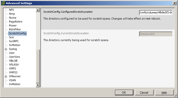

    Logging is obviously enabled, besides that I have no clue why.
    ~ # vim-cmd hostsvc/advopt/view ScratchConfig.ConfiguredScratchLocation
    (vim.option.OptionValue) [
       (vim.option.OptionValue) {
          dynamicType = <unset>,
          key = "ScratchConfig.ConfiguredScratchLocation",
          value = "/vmfs/volumes/56ba86bf-58db69c8-5cca-0cc47a6af506/.locker",
    Is there any way to temporarily disable the scratch partition? I can't find any information on that. Unfortunately this is the only datastore available to the ESXi host, so I can't change it to some other location.

    I'm sorry to say this, but I can't set the value of ScratchConfig.ConfiguredScratchLocation to blank. It accepts a blank value, but it resets it back to the old value. Even after restarting the agents or the whole ESXi host, the old value still exists. There must be something else which has configured this. I knew that the scratch settings are disabled by default when you install ESXi on a USB stick. I have not manually configured this, so I'm still wondering why it actually is configured.

    Ok, a blank value is invalid to reset it to default behavior (even though the value is really empty by default), but the default logging location when no scratch is configured should be /tmp/scratch (local ramdisk only), try to manually set that.
    It appears you still actually have to reboot the host for the new value to take effect and be reflected in the ScratchConfig.CurrentScratchLocation parameter though, but if you're lucky a management agent restart could be sufficient:
    I just confirmed this myself after trying to change the scratch location:
    > Get-VMhost myesxi | Get-AdvancedSetting | Where {$_.Name -like '*scratch*'} | Select Name, Value | FT -AutoSize
    Name                                                   Value
    ScratchConfig.CurrentScratchLocation                  /tmp/scratch
    > Get-VMhost myesxi | Get-AdvancedSetting -Name "ScratchConfig.ConfiguredScratchLocation" | Set-AdvancedSetting -Value "/vmfs/volumes/[VMFS-ID]/.locker-myesxi"
    Name                                                           Value
    ScratchConfig.ConfiguredScratchLocation                      /vmfs/volumes/[VMFS-ID]/.locker-myesxi

    First of all I have to say I really appreciate your help - thanks alot for this. Unfortunately when I try to change the scratch location to /tmp/scratch it says that the value is invalid.

    This error is probably because you manually deleted something, see: Manually setting a scratch location for ESXi in the vSphere Client appears to succeed but the setting is not honored (20…
    You might also need to recreate the /vmfs/volumes/<your_volume_here>/.locker directory.
    If this is still not working then you should make sure the /tmp/scratch folder exists (e.g. SSH in and mkdir /tmp/scratch).
    You should then be able to follow the instructions to set the directory to /tmp/scratch or whatever. You may need to reboot between steps.
    This still wasn't working fully for me so I just setup scratch to be /tmp rather than /tmp/scratch which finally did the trick for me.
    Once all that is done you should be able to unmount the datastore.
