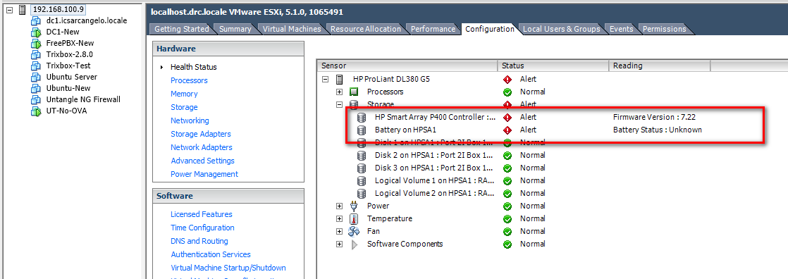

    From about two weeks my Esxi server on HP Proliant DL 380 G5 shutdown unexpetedly  every two days.
    After that I must manually restart it.
    If I see on the vSphere dashboard the only alert message is this:
    Any idea on how to fix it?

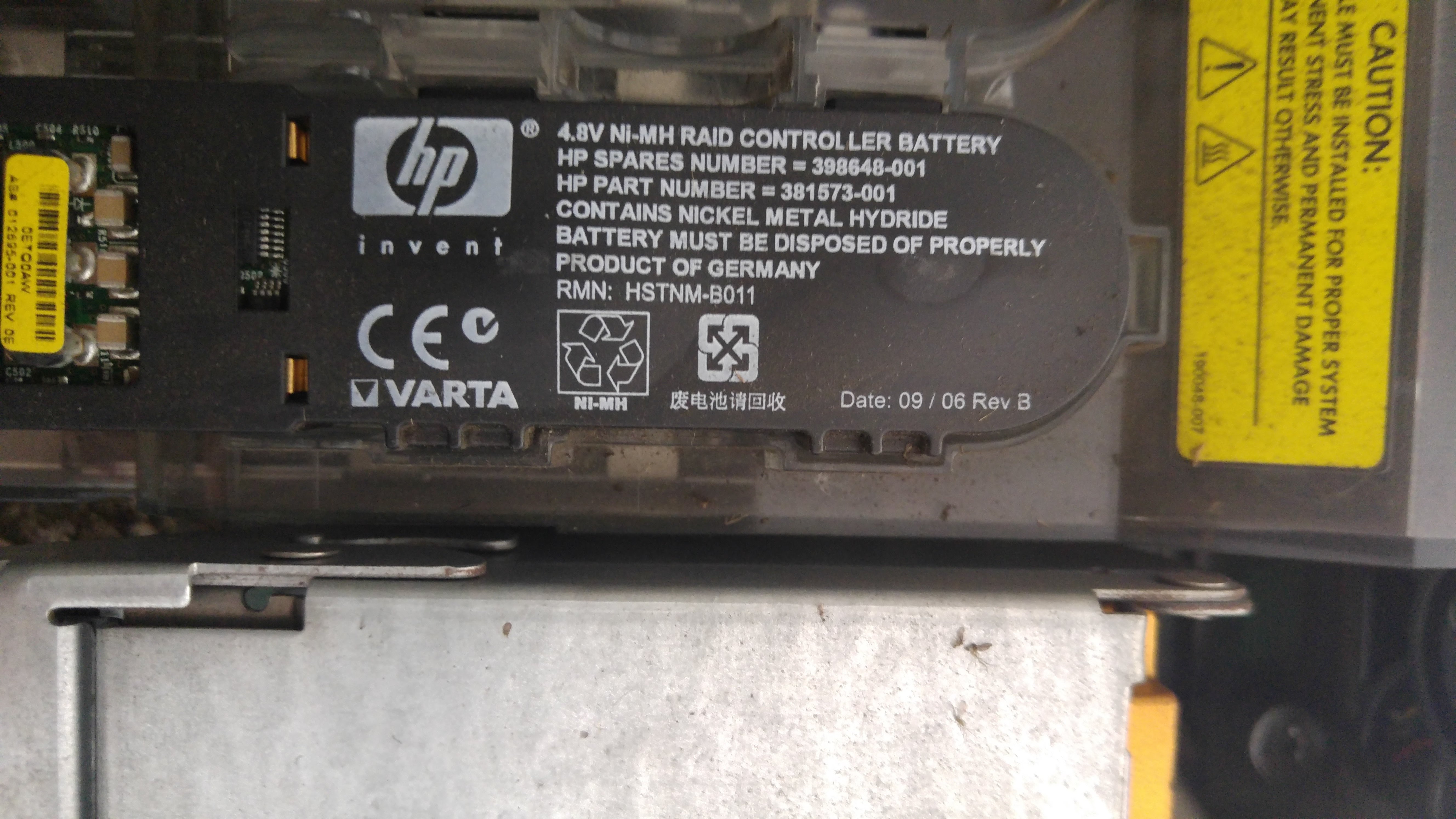

    That usually means the cache battery on the storage controller is dead and you must replace it. As to whether that is responsible for the ESXi host shutdowns, don't know, but if you are using those internal drives in a RAID configuration and especially using write-back caching, you should plan to replace it ASAP.

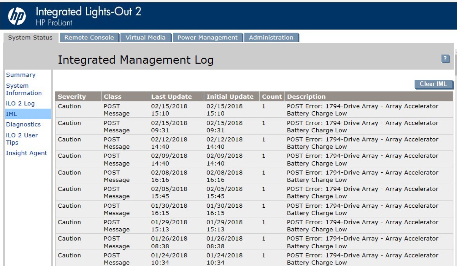

    For the unexpected shutdown, login to the server's iLO, and  check the System Management Logs.

    Cache battery is necessary to avoid data corruption in case of unexpected power loss when write cache is enabled.
    So try to disable write cache in controller's BIOS or from ACU cli first.
    If this doesn't help, try to detach it physically.
    When you disable write cache expect write performance degradation.

    I've just configured iLo 2 and I've founded this:
    At this point I think that I must replace the battery pack:
    What do you think about?

    If you can replace the battery obviously you need to do this.
    If you can't - disable write cache on the contoller.
