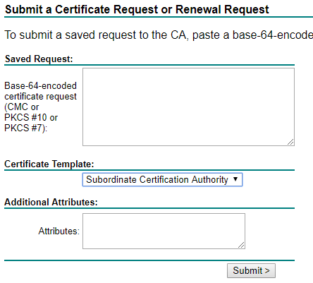

    In order for the VMCA to function as a subordinate for your PKI, you have to generate a cert based on the correct template. You can't just generate any old machine certificate. There's a KB here that talks about that. The default template, which should be cloned and customized, appears here.
    From there, you have to choose option #2 to replace the certificate in the vCSA and regenerate all certs based upon it. Note that this really isn't the recommended way to go about custom certificates. The best way is the hybrid approach where you replace externally-facing services with a custom cert (machine SSL cert) but you leave VMCA to generate certs for solution users and ESXi hosts internally. This is not only easier to accomplish, but easier to maintain as well. You can still trust the VMCA root certificate in order to trust the certs generated for each ESXi host.
