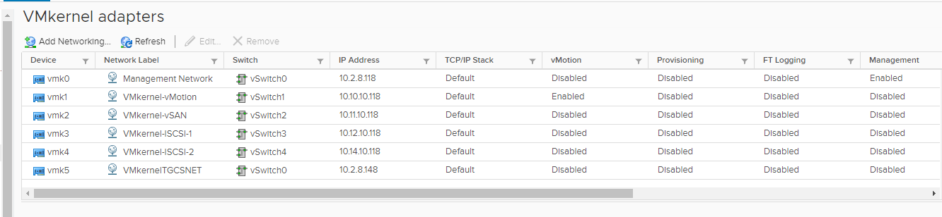

    Check all your vMotion VMKs and be sure that they tagged for "vMotion" and not also some of the other VMKs you have.

    ALL my VMK's are the exact same on all ESXI hosts.  and they are on a separate subnet
