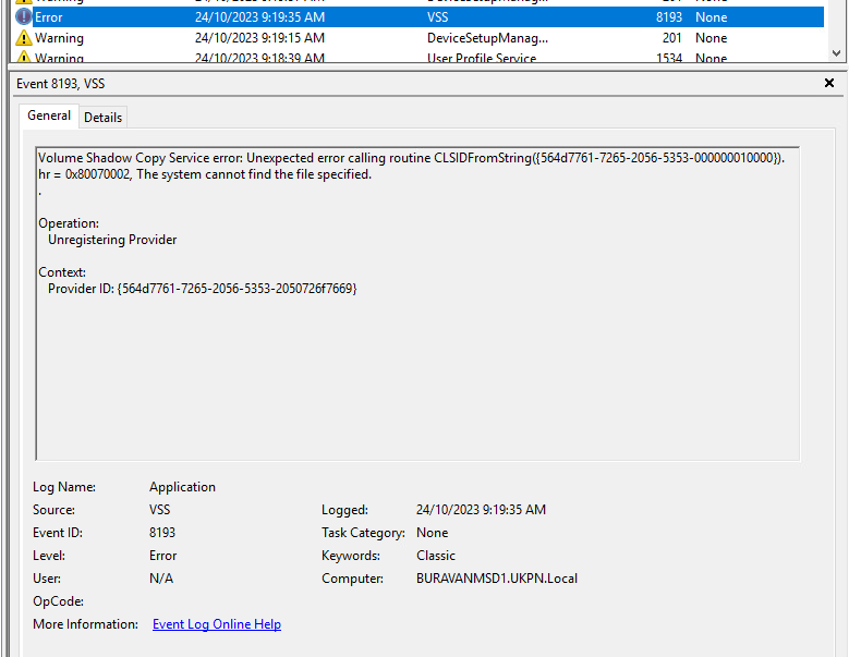

    Looking at the Windows event log on the two VMs, I see one VSS event ID 8193, as shown below:

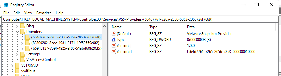

    Searching the registry for the provider ID, I see this is the VMware Snapshot Provider:

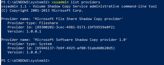

    The Vmware Snapshot Provider must be available, as it shows as a service in Services. Listing the providers via vssadmin however, it is not registered:
    Deleting the registry entries for that provider, allows the snapshot to complete successfully, but the VM bluescreens. Restoring the entries reverts the behaviour to failing snapshots.
    I have tried reinstalling/uninstalling and installing VMware tools, but this does not seem to have helped.
