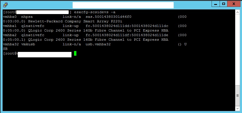

    Can you show us a
    esxcfg-scsidevs -a
    It it possible to "unload" modules.
    Regards,
    Joerg
  • 8.  RE: Unable to remove a VIB which is blocking upgrade
    Posted Aug 25, 2022 08:33 PM
    Screenshot as requested:
