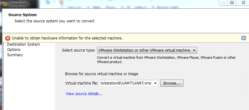

    It's been a long, hard struggle to get this far, but now that I have successfully installed the ESXi Hypervisor on my powerful Dell T710 Server, I am not able to convert the thousands of hours worth of Virtual Machines that I've built using VMware Workstation 7/8.
    I've read countless articles/forums, and nothing has worked.:smileyconfused:
    I've tried:
    1. Using the latest version of VMware Convertor Standalone.
    2. Using version 5.0.1 build 875114.
    3. Accessing the source files on the local stand-along workstation.
    4. Accessing the source files on the remote server.
    5. Loading all versions of the standalone on the server (while booted into Windows Server 2008 R2).
    6. Accessing the remote machine using loopback adapter IP address 127.0.0.1 as the host.
    7. Running under just about every privileged user account.
    I have about 10 hours into this problem and I don't know what to try next.
    I simply cannot load ANY VMware Workstation VMs into the conversion tool.:smileyshocked:
    Any thoughts?

    1. I booted from ESXi.
    2. I started VMware vSphere Client on a Windows 7 PC that has access to the ESXi server IP address.
    3. I started the VMware vCenter Converter Standalone application on the Windows 7 PC.
    4. I connected to another Windows 7 PC that contains the source VM that is to be converted.
    5. I received the error (Again) when I attempted to hit the Next button.
    Still no success.
    What do you recommend ?

    1. You cannot simply copy the VM to another computer and convert it.  That is what I was trying to do.  The only VMware software that was loaded on the 'holding' computer was the VMware Standalone Converter.  Not enough apparently.
    2. I had to install VMware Workstation 8 on the 'holding' computer.  Opening the vm in VMware Workstation 8 was a challenge in itself ! I had to hack the configuration file to get past a file permissions error.  That was frustrating.:smileyangry:
    3. After I was finally able to Open the copied vm into Workstation 8, I closed it out, and then the Conversion went without a hitch (sort of).
      I'm guessing that the conversion needs to grab hardware information from the machine holding the vm AFTER it has been Opened in Workstation 8 !:smileyconfused:
