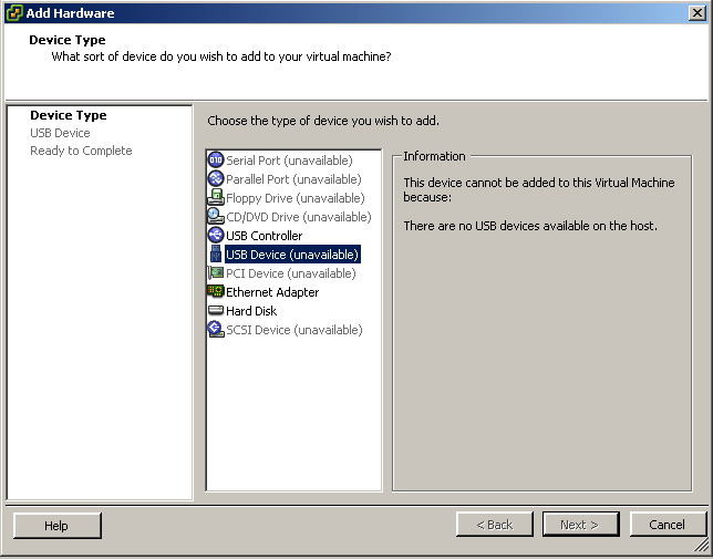

    In the vSphere client, I don't see any USB devices that I can add to my VMs.
    Anyone know what's up?

    I think that it's worth checking that you have added a USB Controller to the virtual machine before plugging in the physical USB device to the Host.
    The screenshot by daemonchild shows that the controller is available for him to add to the virtual machine (which means that it's not already added).
    Once the controller is added, the physical usb device can be plugged in to the host, and then the virtual "USB Device" can be added to a virtual machine.
    These are the steps required, although I have also found that USB device passthough doesn't always work as you'd expect.
