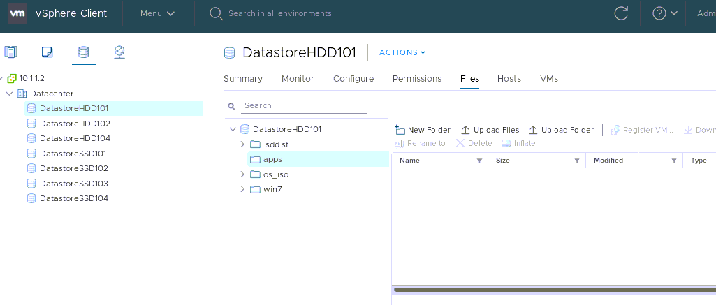

    In vSphere 6.7, I want to delete a folder in datastore, but the delete button is disabled.
    I guessed that non-emty folders won't be deleted. However, after deleting files inside the folder, still I can not remove the folder.
    Please see the picture below.

    Please select "DatastorHDD101" in the tree structure, which should display the folders in the right pane. Selecting the "apps" folder there should allow you to delete it.

    If you see the first post, I pasted an image, where I have browsed to datastoreHDD101 and the app folder has been selected. But as you can see the delete button is not enabled.

    That's what I was referring to. What if you select the "DatastoreHDD101" in the mid pane, rather than the apps folder?

    O Yes you are right.
    I got it. See the picture. Thank you.

    simply click on the datastore name, not the folder. Then you'll be able to delete what you want.

    You can only use the "DELETE" option for folders when the folder is selected from the farthest right tier.  You have to select the "DATASTORE" in the middle tier and then highlight the folder in the 3rd tier (all the way on the right side).  Once you select the folder all the way in the right column, you will be given the DELETE option at the top.
