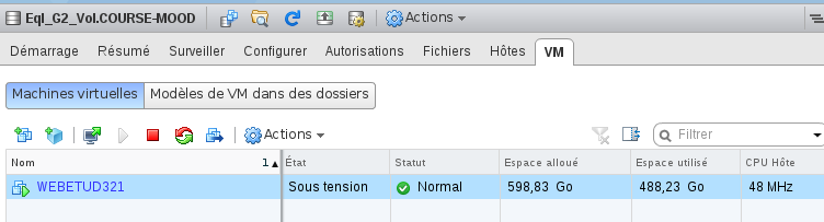

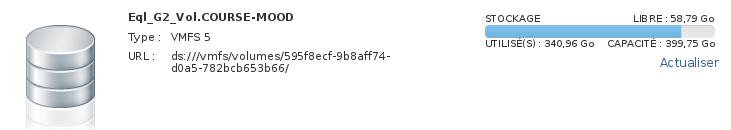

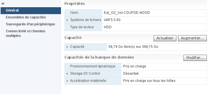

    The datastore is a volume created in a san equallogic. From the VM i have had created a new disk and pointed it  to the datastore
    here is the state of the datastore :
    Summary tab :
    files Tab :
    VM Tab
    yesterday, i reset Vcenter,  i put the datastore online and mount it from the host witch manage the VM in question. In this VM ( webetud321 in the screenshot) the partition witch was pointing to the datastore  is deleted, but not the files, they  remained in the datastore.

  • 4.  RE: unable to delete a datastore
    Posted Mar 13, 2019 11:07 AM
    Hi quartz201110141,
    Removing or deleting the partition within the VM will not free space on the datastore or array... well not unless you have Thin provisioned LUNs and the like.
    I'm understanding that you are wanting to remove the VMDK files from the datastore called Eql_G2.COURSE-MOOD (as per your screenshot)? If so then you will have to remove the snapshot (do not select 'revert' or you will lose all your changes) before you can remove the VMDK from the machine and free the space from the datastore. Another option is to use either Storage vMotion or migrate the VM when it is powered off if you don't have this feature available. If you select the advanced options you can just move the individual VMDK rather than the whole machine.
    Make sure you have a good and tested backup if you are concerned with consolidating your snapshots. It's considered not a very good idea to run snapshots for an extended period of time so unless you have a very specific reason for keeping the VM running under a snapshot, you should be considering removing them anyway.

  • 6.  RE: unable to delete a datastore
    Posted Mar 14, 2019 10:44 AM
    Hi ThompsG, Hi hassan
    First i tried to increase the data, but because of some problem i decide to delete it. Unfortunately it persist because the VM seem to still use it although the partition is delete.
    ThompsG points that the snapshot is involved. So as ThompsG suggest, il m going to stop the VM, to migrate it ( via à copy) in another host and process a consolidation.
    to be continued ...
    thanks for all
  • 7.  RE: unable to delete a datastore
    Posted Mar 15, 2019 09:30 AM
    Hi !
    Once the VM stopped, i clone it ( i have to clone it in an other host but also at the same time in another datastore).  everything went well and the VM start normally.
    moreover i also do a snapshot  ( VM was stopped), i was warned that some snapshot could be deleted ( i supposed the snapshot of the partition deleted previously). everything went also well and the link to the datstore was breaked, and i could delete it.
    Thanks to everybody !
