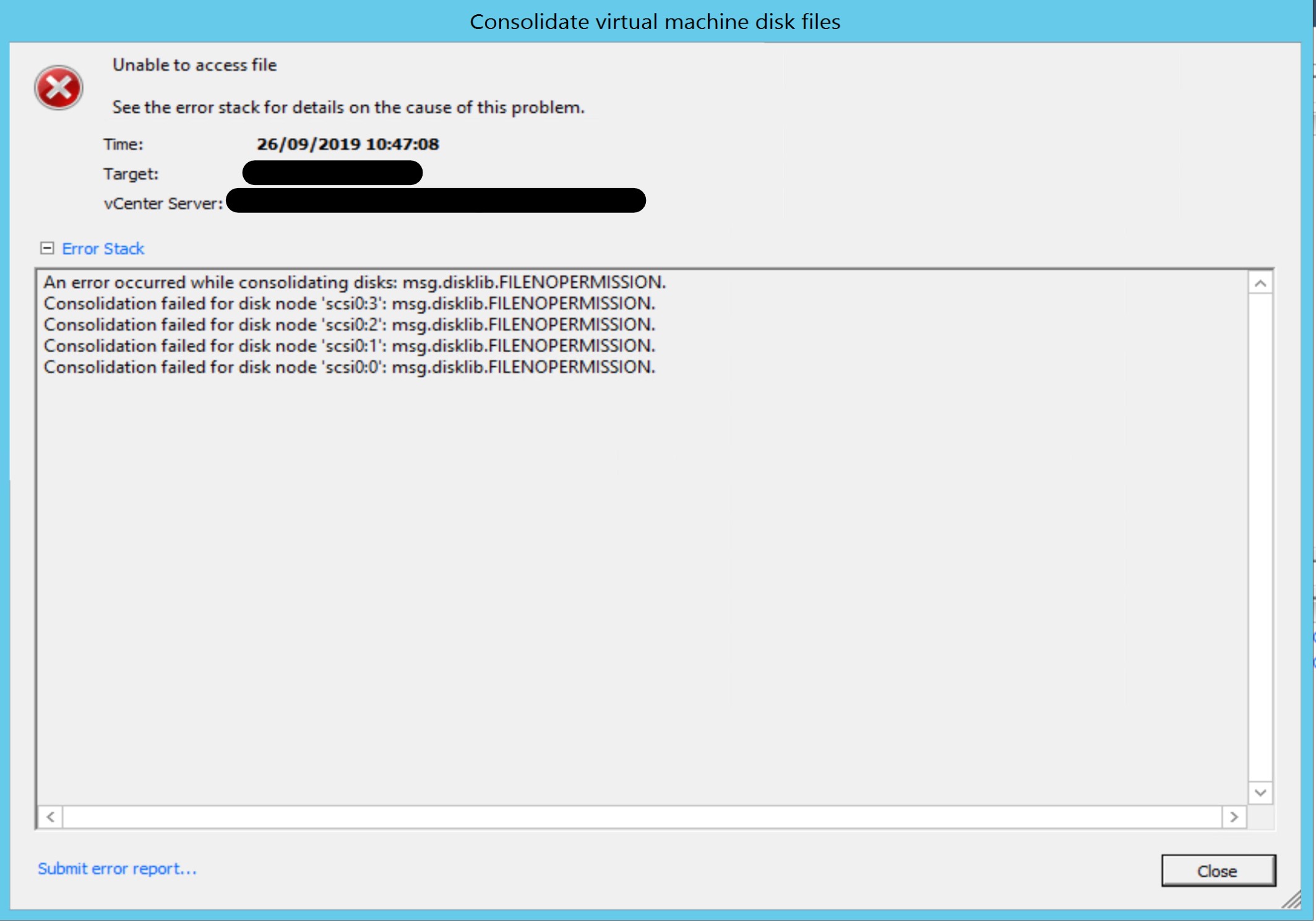

    We have register a VM on vCenter and unfortunately, it seems that the disk consolidation is needed.
    But unfortunately, when we run the consolidation, we are getting this error message :
    An error occurred while consolidating disks: msg.disklib.FILENOPERMISSION.
    We tried to stop the VM but unfortunately no luck still the same error message.
    Did anyone already face this issue ?
    Thanks

    We finally found the issue, since we are using some network tool for backup, while reverting the snapshot, some ID on the vmdk were still referring to the backup folder, here is an example :
    [root@esxihost:/vmfs/volumes/a59a2c87-xxxxxxxx/myvirtualmachine-restored] cat myvirtualmachine-000002.vmdk
    # Disk DescriptorFile
    version=1
    encoding="UTF-8"
    CID=xxxxxxx
    parentCID=8xxxxxxx
    isNativeSnapshot="no"
    createType="vmfsSparse"
    parentFileNameHint="/vmfs/volumes/a59a2c87-xxxxxxxx/.snapshot/daily.2019-09-24_0010/myvirtualmachine/myvirtualmachine.vmdk"
    # Extent description
    RW xxxxxxxxxx VMFSSPARSE "myvirtualmachine-000002-delta.vmdk"
    # The Disk Data Base
    #DDB
    ddb.longContentID = "1281b2ca1xxxxxxxxxxxxx1cbc90"
    ddb.toolsVersion = "1xxxx9"
    So by removing ".snapshot/daily.2019-09-24" we were finally able to consolidate the machine.
    Thanks for all of your suggestion.
