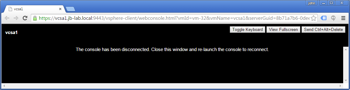

    I hate to use the Web Client under any circumstances, but it does represent a valid test.
    The Web Client console never connected and will not re-connect, and gives the message: "The console has been disconnected. Close this window and re-launch the console to reconnect."

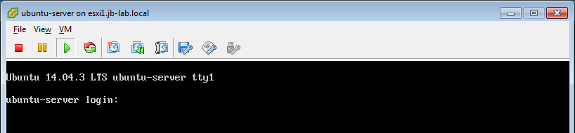

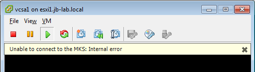

    This is what the Windows client for the same VM looks like (prior to a power-cycle of the VM):
    This is what the Windows client looks like to another VM on the same host (but only after I powered the VM off and back on):

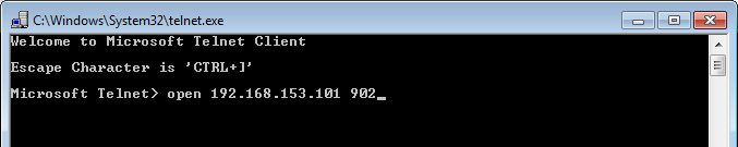

    Telnet to host:

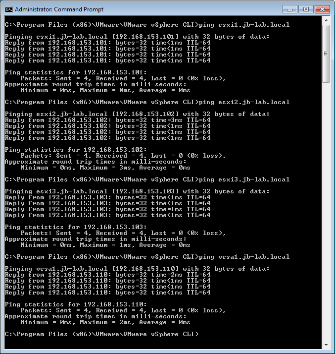

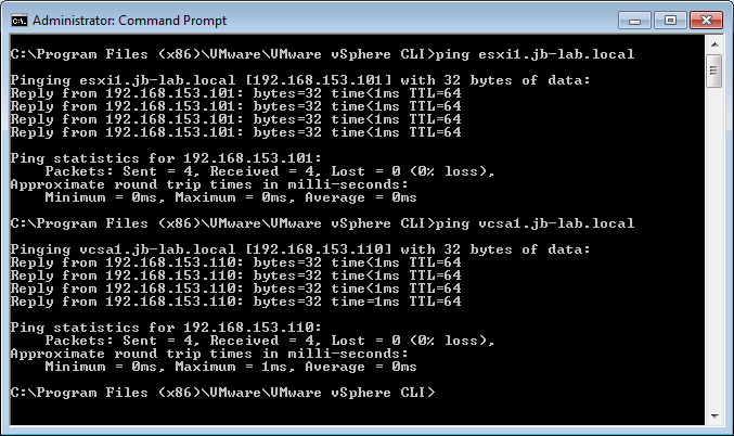

    Ping by hostname:
