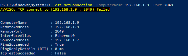

  • 5.  RE: Unable to connect to NFS server.
    Posted Oct 27, 2021 02:51 PM
    Hi khiregange
    I've tested connectivity on between Veeam Server and ESXi host on port 2049 and it fail.
    On the windows Veeam server all firewall are disabled.
    No any other firewall is between the ESXi 's Magement network and Veeam Windows PC.
    I don't know what can stop connection.
    Any idea?
