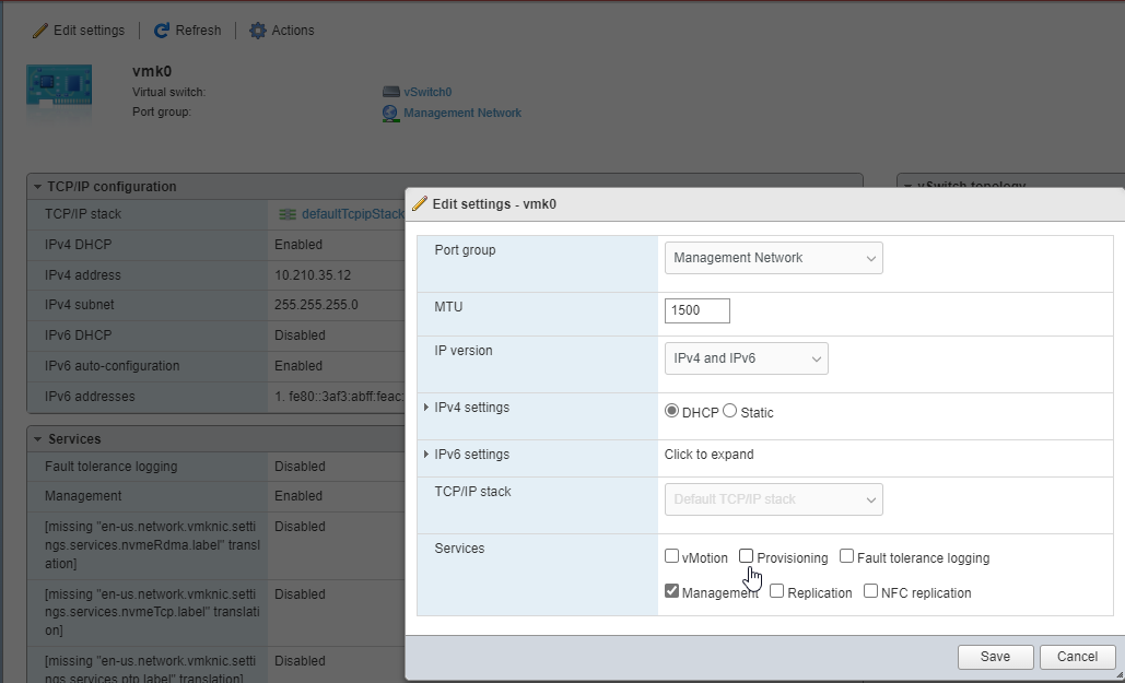

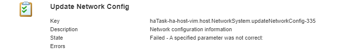

    I have a similar or even the same issue.
    GUI complains with
    Update Network Config
    Key
    haTask-ha-host-vim.host.NetworkSystem.updateNetworkConfig-335
    Description
    Network configuration information
    State
    Failed - A specified parameter was not correct:
    Errors
    even if I try to set provisioning
    When I try to set static settings via console I get:
    /vmfs$ esxcli network ip interface ipv4 set -i vmk0 -I ip 10.210.35.2 -N 255.255.255.0 -t static
    Error: Invalid option 10.210.35.2

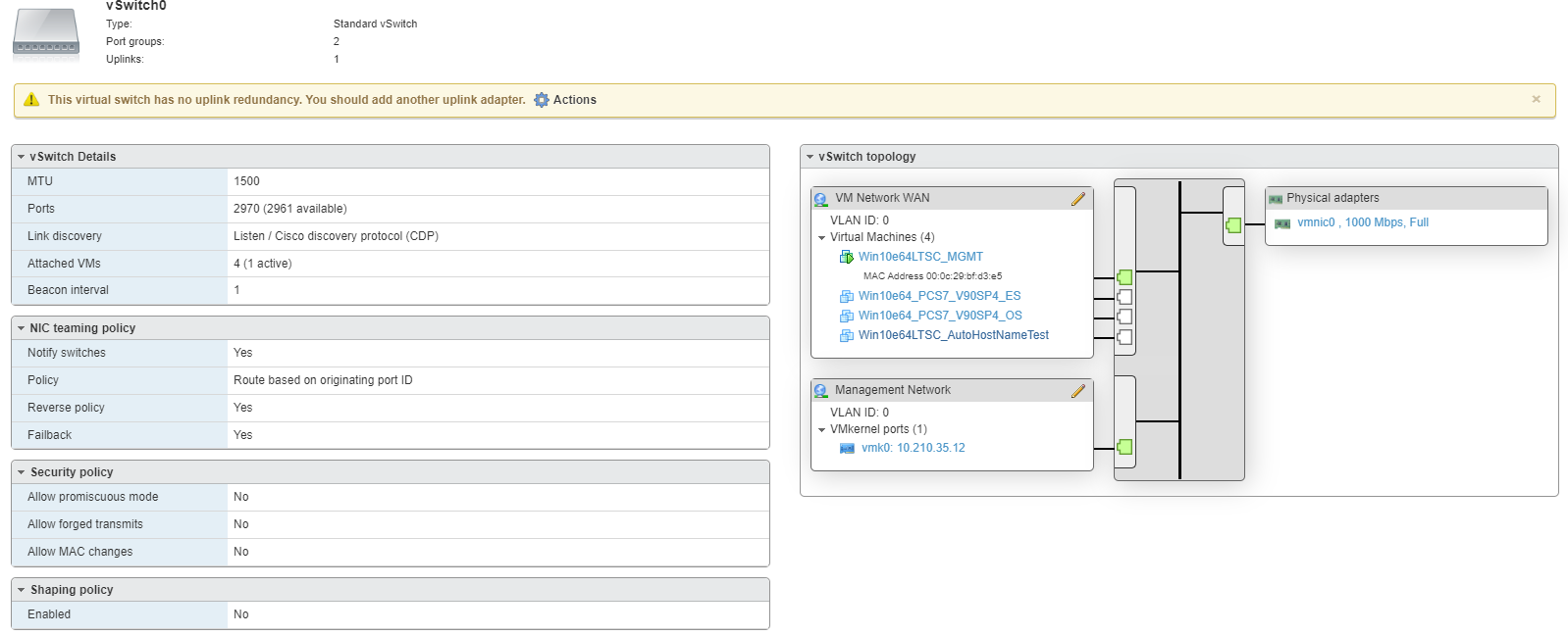

    here is the management network
    NIC
    SWITCH

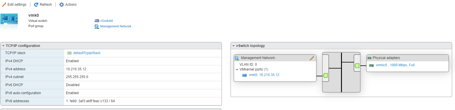

  • 11.  RE: Unable to change IP network address
    Posted Dec 10, 2022 12:32 PM
    I set IP etc during the initial install. That happened in DCUI.
    As soon as I'm on the WebGUI I get errors like shown in the images shown in the initial post
