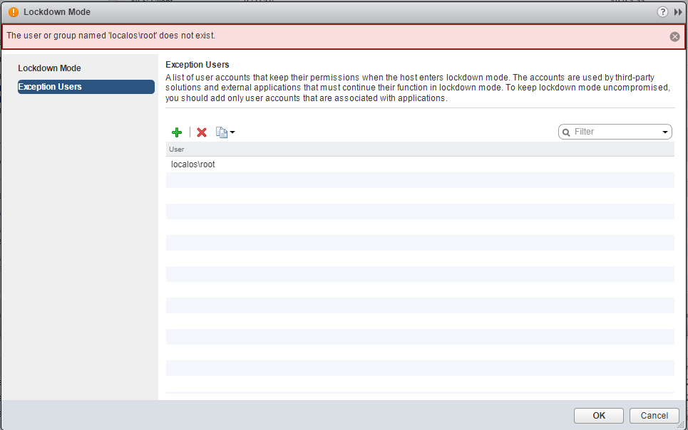

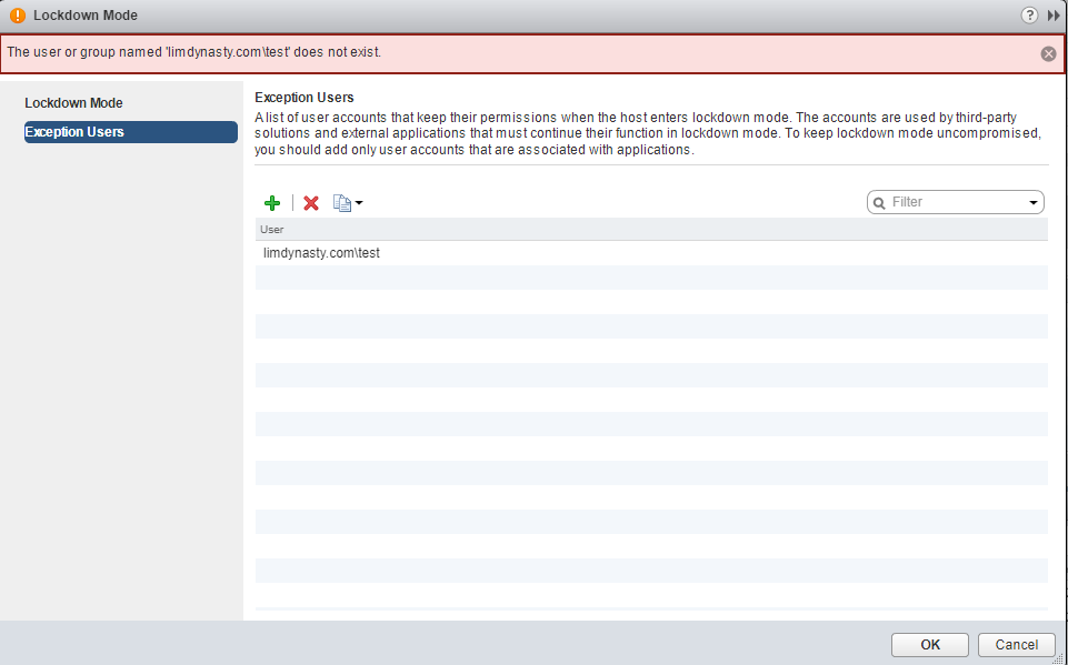

    I am having issues with adding a Exception User in Lockdown Mode. I am running ESXi 6.7 and enabled Lockdown Mode - Strict. Then I want a AD user to be excluded from the lock down. This AD User is a limited user.
    I know my connection to the AD is functional because when I create a test account to the OU that vCenter is looking I can see the test accounts I added. However, when I add a user in Exception Users in Lockdown Mode i get this error message.
    This seems to be happening to any user as well including local users.
    Any ideas?
  • 2.  RE: Unable to Add Exception users in Lockdown Mode
    Posted Nov 19, 2018 09:31 AM
    use your lymdynasty\user without  .com at your domain name
  • 3.  RE: Unable to Add Exception users in Lockdown Mode
    Posted Nov 25, 2018 04:28 AM
    Tried this, didn't work.

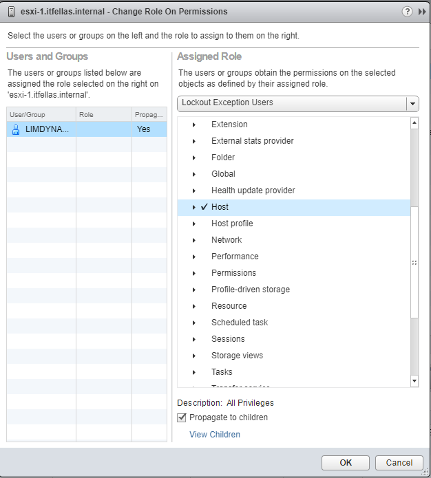

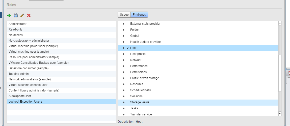

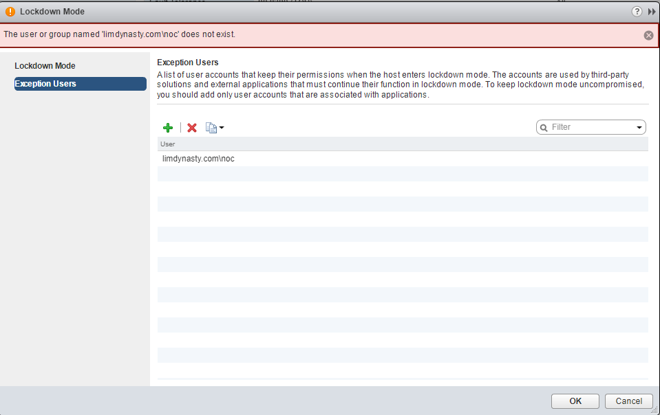

    So I tried what you said,
    1. I created role named "Lockout Exception Users" with Host Permission.
    2. Then, I defined the domain user, limdynasty\noc with the permission lockout exception users on the ESXi host.
    3. When adding the noc user to the exception user, it still failed saying the account does not exist.
    NOTE: I tried creating a local noc account on the ESXi host and added the lockdown exception user from the ESXi and enabled the strict lockdown from vcenter server, however this ended up no users logging in.
  • 6.  RE: Unable to Add Exception users in Lockdown Mode
    Posted Nov 26, 2018 02:41 PM
    The permissions must be defined locally on the ESXi host and not through the vCenter. So you have to log on to the ESXi host with the host client and select "Action" on the top of the Welcome Screen (Default Host View) and choose "Permissions". There you can assign an ESXi privilege role to a specific ESXi user.
    For this reason, the vCenter AD permissions do not work either, because you are working locally on the ESXi host and not through the vSphere client.
    Maybe these information will also help you to understand why no one can log in anymore:
    Lockdown Mode Behavior
