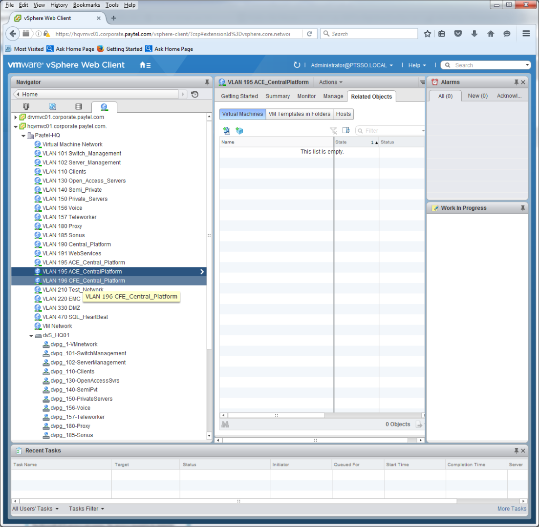

I have a new setup which is ESXi 6, somehow i got two separate instances of VLAN 195 ACE CentralPlatform, I am trying to delete one but can't figure out how. Can anyone help
Take a look at the official documentation: Remove a Port Group from a vSphere Standard Switch in the vSphere Web Client
You can remove port groups from vSphere standard switches in case you no longer need the associated labeled networks.
Verify that there are no powered-on virtual machines connected to the port group that you want to remove.
Procedure
In the vSphere Web Client, navigate to the host.
2
On the Manage tab, click Networking, and select Virtual switches.
3
Select the standard switch.
4
From the topology diagram of the switch, select the port group that you want to remove by clicking its label.
5
From the toolbar in the switch topology, click the Remove selected port group action icon .
