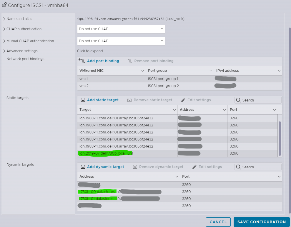

    Our Meraki network switches had their firmware updated, and all of a sudden 3 out of 4 ESXis lost connectivity to an iSCSI target.
    (The target is a Dell r730 server running Ubuntu 22.04.3 LTS with the sole purpose of being iSCSI storage for a VMware cluster. The ESXi hosts are 7.03.)

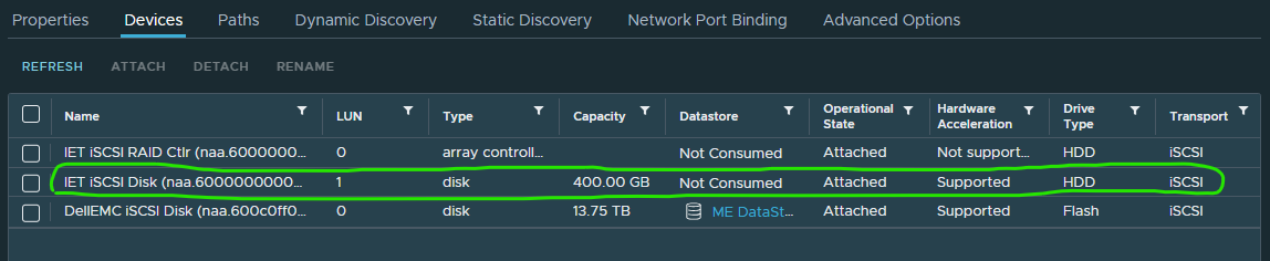

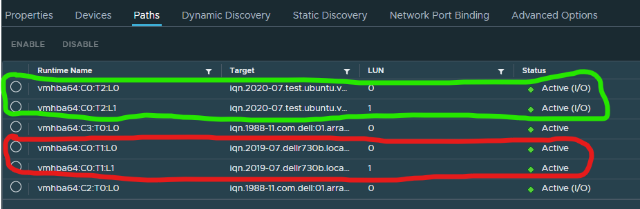

    When scanning the iSCSI storage adapter on an ESXi host that can no longer mount the datastore, the host appears to recognize the LUN: it adds an item to "static targets" - based I am assuming on scanning the dynamic ones:
    (The device / target / LUN is highlighted in green.)
    Yet I don't see it presented as a "device" though (which I could mount as a datastore, or where I could create one) under "devices":

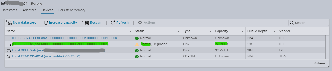

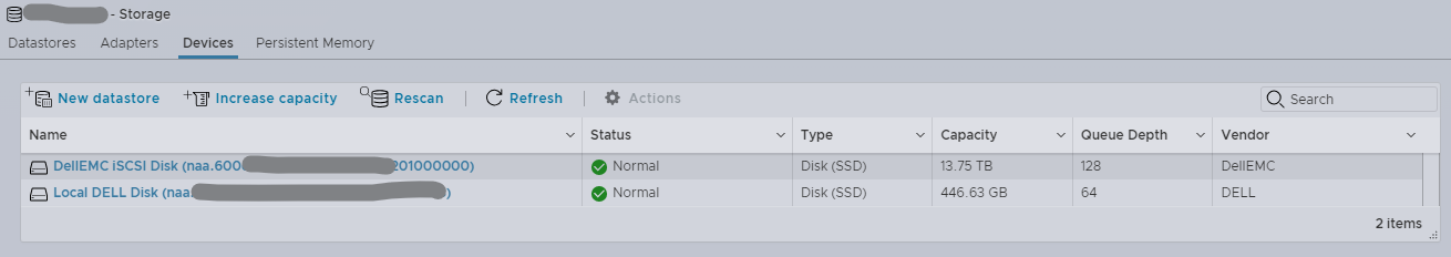

    For comparison, here is one of the ESXis that can see the device:
    It shows as "degraded" (probably because of lack of NIC redundancy - where would I look to confirm?) - yet it does show up, and I can seemingly create a datastore on that target.
    I also spun up an older standalone ESXi 6.7 and it can also see the device. My Windows desktop - ditto.
    How would I troubleshoot this issue on the ESXi hosts that can't seem to recognize the iSCSI target as a valid device?

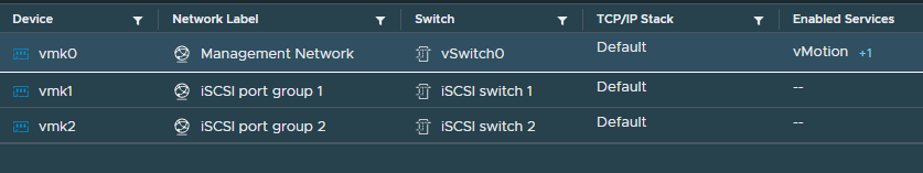

    Could this be relevant? All iSCSI connection failures occur on vmk1 and vmk2 (which have no network connection to the target), and there isn't anything for vmk1 - which is the NIC that the has the network path to the iSCSI target in question.
    2023-08-07T22:49:25.324Z: [iscsiCorrelator] 569241542us: [esx.problem.storage.iscsi.target.connect.error] Login to iSCSI target iqn.1988-11.com.dell:01.array.bc305bf24e32 on vmhba64 @ vmk2 failed. The iSCSI initiator could not establish a network connection to the target.
    2023-08-07T22:49:25.325Z: [iscsiCorrelator] 569233690us: [vob.iscsi.target.connect.error] vmhba64 @ vmk2 failed to login to iqn.1988-11.com.dell:01.array.bc305bf24e32 because of a network connection failure.
    2023-08-07T22:49:25.326Z: [iscsiCorrelator] 569242709us: [esx.problem.storage.iscsi.target.connect.error] Login to iSCSI target iqn.1988-11.com.dell:01.array.bc305bf24e32 on vmhba64 @ vmk2 failed. The iSCSI initiator could not establish a network connection to the target.
    2023-08-07T22:49:25.326Z: [iscsiCorrelator] 569234520us: [vob.iscsi.target.connect.error] vmhba64 @ vmk1 failed to login to iqn.1988-11.com.dell:01.array.bc305bf24e32 because of a network connection failure.
    2023-08-07T22:49:25.326Z: [iscsiCorrelator] 569243520us: [esx.problem.storage.iscsi.target.connect.error] Login to iSCSI target iqn.1988-11.com.dell:01.array.bc305bf24e32 on vmhba64 @ vmk1 failed. The iSCSI initiator could not establish a network connection to the target.
    2023-08-07T22:49:25.327Z: [iscsiCorrelator] 569235334us: [vob.iscsi.target.connect.error] vmhba64 @ vmk1 failed to login to iqn.1988-11.com.dell:01.array.bc305bf24e32 because of a network connection failure.
    2023-08-07T22:49:25.327Z: [iscsiCorrelator] 569244253us: [esx.problem.storage.iscsi.target.connect.error] Login to iSCSI target iqn.1988-11.com.dell:01.array.bc305bf24e32 on vmhba64 @ vmk1 failed. The iSCSI initiator could not establish a network connection to the target.
    vmk1 and vmk2 are kernel NICs dedicated to direct-attached iSCSI connections. They do not have a path to the iSCSI target in question that is on a switched network.
    I guess I am puzzled why doesn't the ESXi attempt to connect to the target using vmk0, and what I can do to force it to.

    In your initial thread you refer to vmk1 & vmk2 and added also snippets from the configuration.
    in your last thread you mention that vmk0 is the one to focus on and that vmk1 & vmk2 aren't the interfaces which should handle the iSCSI traffic/connection
    So which statement is correct?
  • 11.  RE: Troubleshooting iSCSI
    Posted Aug 29, 2023 11:46 PM
    Sorry about that - it's all very confusing to me too.
    vmk1 and 2 should not handle connections to the iSCSI target in question (located on a switched network). Only vmk0 can handle those as that's the only adapter with a path to it.
    (vmk1 and 2 are adapters for direct-attached connections only, i.e. for targets not on a switched network)
    If that still doesn't clear it up - let me know.

    What I'm worried about is the iSCSI Port Binding configuration.
    Port Binding should only be used in single-subnet iSCSI configurations, i.e. where all initiators (vmkX) are able to reach all targets. This however is not the setup that you are using, is it?
    Is this configured the same as on the other, working ESXi hosts?
    André
  • 15.  RE: Troubleshooting iSCSI
    Posted Aug 30, 2023 06:31 PM
    Agreed, that was my bad - enabled it before reading up on it - but after this issue occurred - yet it doesn't appear to affect anything.
    First three hosts have the same configuration, the fourth one doesn't (as it's not connected to the direct-attached ME4024 iSCSI target, unlike the first three).
    As soon as I can put one of them in maintenance, I'll remove the binding, see if that does anything - but am not expecting it to.
    (Putting it in maintenance is tricky as our cluster is running low on memory - so I am trying to tread gently.)

    Put one of the affected hosts in maintenance, removed the binding, re-scanned the adapter - and while the ESXi still doesn't see the iSCSI target in question, it does now see a test one I just created yesterday on an Ubuntu VM.
    (In green are the paths to the new test iSCSI target, in red - to iSCSI target the hosts can no longer see.)
    Another new development is that the 4th ESXI that used to see the iSCSI target in question - can no longer see it. (The only change was the server running that iSCSI storage - Ubuntu Linux on Dell r730 - was updated via 'apt-get upgrade' and rebooted today.)
    With all this, the culprit is possibly with the Ubuntu Linux iSCSI service configuration (tgt)?

    The culprit wasn't network port binding - it seems to have something to do with ESXis holding on to stale paths and items in Dynamic and Static Discovery.
    Here are some tests I did:
    1. Enable (deliberately misconfigured) Network Port Binding (on unrelated vmks not connected to the iSCSI targets in question, and on vmks not in the same local subnet - i.e. a deliberate misconfiguration to see if this would cause issues with an iSCSI target and datastore attached to a different vmk)
      • The datastore on the iSCSI target in question is still accessible and browsable
      • Rescanned the adapter - no change
      • Rebooted the ESXi host - no change
      • Disconnected the datastore in question by removing items in static and dynamic discovery and rescanning the adapter
      • The datastore in question is no longer accessible
      • Added needed items to the Dynamic Discovery, rescanned the adapter
      • The device and the datastore showed up
      • (I think this demonstrates that misconfigured Network Port Binding had no effect on this issue.)
    2. CHAP misconfiguration resulting in losing access to the datastore, restored only by removing and re-adding the datastore - by removing relevant items in Dynamic and Static Discovery, rescanning, and then re-adding them.
      • Configured CHAP (incoming) authentication on the target (no changes on the ESXi hosts - not yet)
      • The datastore became inaccessible
      • Tried to configure one of the ESXi hosts to use CHAP authentication. No luck - likely something I was doing wrong. Or, possibly, it's the same "stale info" issue and I needed to remove and re-add the target before the ESXis could access the datastore with CHAP configured.
      • Cleared CHAP configs on both sides, restarted iSCSI service on the target, rescanned the adapter - no change.
      • Rebooted the target, rebooted the ESXi host, verified iSCSI configuration, rescanned several times - no change. Datastore still inaccessible.
      • Removed the relevant items in the Dynamic and Static Discovery, rescanned the adapter - thus effectively removing the datastore. Re-added them on one (not all) of the ESXi hosts. The datastore magically showed up. Surprisingly, it also showed up and became accessible on all other ESXi hosts - without any changes there - without even rescanning or refreshing anything. (Weird, isn't it?)
        • I think this was the original issue I experienced. The datastore was available and could be connected all along, I just needed to not just rescan the adapter, but perform the above steps of effectively removing the iSCSI target, re-scanning, re-adding it, and hoping the device and the datastore would show up.
    To sum up, if an iSCSI datastore disappeared on an ESXi host and isn't showing up no matter how many times you reboot or rescan, try this:
    1. Remove the target and the datastore by:
      1. removing relevant items in Static and Dynamic Discovery tabs in "iSCSI Software Adapter" configuration on an ESXi host
      2. re-scanning the adapter and confirm the relevant device(s) and the datastore are gone
    2. Re-add the target by re-adding the relevant items back to Static and Dynamic Discovery, and re-scanning the adapter.
    This worked for me and I hope this works for someone else in a similar situation.
