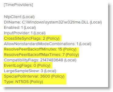

  • 10.  RE: Time Sync Errors
    Posted Aug 20, 2012 12:57 PM
    I think you may be looking at the wrong status. w32tm /query /status returns the status of the local system which gets the time from its CMOS clock. However w32tm /query /peers and/or w32tm /query /configuration show the NTP server which is used to synchonize the local time with.
    André
    Message was edited by: a.p. - fixed typos
  • 11.  RE: Time Sync Errors
    Posted Aug 20, 2012 01:04 PM
    These are the two outcomes from those commands:
    #Peers: 1
    Peer:
    State: Pending
    Time Remaining: 877.3437500s
    Mode: 0 (reserved)
    Stratum: 0 (unspecified)
    PeerPoll Interval: 0 (unspecified)
    HostPoll Interval: 0 (unspecified)
    and
    EventLogFlags: 2 (Local)
    AnnounceFlags: 5 (Local)
    TimeJumpAuditOffset: 28800 (Local)
    MinPollInterval: 6 (Local)
    MaxPollInterval: 10 (Local)
    MaxNegPhaseCorrection: 1800 (Local)
    MaxPosPhaseCorrection: 1800 (Local)
    MaxAllowedPhaseOffset: 300 (Local)
    FrequencyCorrectRate: 4 (Local)
    PollAdjustFactor: 5 (Local)
    LargePhaseOffset: 50000000 (Local)
    SpikeWatchPeriod: 900 (Local)
    LocalClockDispersion: 10 (Local)
    HoldPeriod: 5 (Local)
    PhaseCorrectRate: 7 (Local)
    UpdateInterval: 100 (Local)
    [TimeProviders]
    NtpClient (Local)
    DllName: C:\Windows\system32\w32time.DLL (Local)
    Enabled: 1 (Local)
    InputProvider: 1 (Local)
    CrossSiteSyncFlags: 2 (Policy)
    AllowNonstandardModeCombinations: 1 (Local)
    ResolvePeerBackoffMinutes: 15 (Policy)
    ResolvePeerBackoffMaxTimes: 7 (Policy)
    CompatibilityFlags: 2147483648 (Local)
    EventLogFlags: 0 (Policy)
    LargeSampleSkew: 3 (Local)
    SpecialPollInterval: 3600 (Policy)
    Type: NT5DS (Policy)
    NtpServer (Local)
    Enabled: 1 (Local)
    InputProvider: 0 (Local)
    VMICTimeProvider (Local)
    DllName: C:\Windows\System32\vmictimeprovider.dll (Local)
    Enabled: 1 (Local)
    I could be reading it wrong but it still all looks like its using a local time source?

  • 13.  RE: Time Sync Errors
    Posted Aug 20, 2012 03:24 PM
    Hmmm something looks to be forcing mine to use NT5DS rather than NTP - im a bit stumped now though :smileyplain:

  • 19.  RE: Time Sync Errors
    Posted Jan 21, 2016 04:19 AM
    Hi,
    Sorry I know I'm a little late to the party but if you are having the same issues as the poster with the same rough outcome after running the w32tm commands, then I suspect that you have a group policy that is setting the Windows Time Service settings. If you take a look at the below screenshot taken from a previous response you can see the highlight in yellow sections are set by group policy:
    Do a gpresult or rsop (depreciated) on the Domain Controller and you should be able to locate the policy that is doing this. Remove it or rather stop it applying to your Domain Controllers and after a gpupdate all should return to normal.
    Kind regards.
