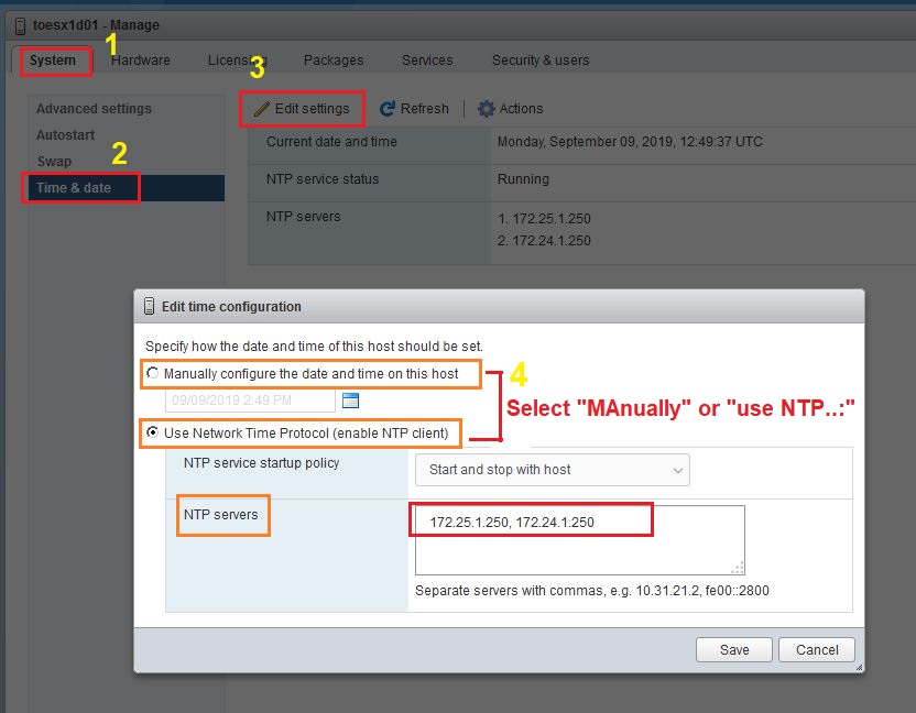

    Generally it is better to create an internal NTP Server that points to the time registration on the internet, then the VCSA and the ESXi hosts take the setting from the NTP Server.
    Alternatively you must manually set the time in each Esxi Host:
