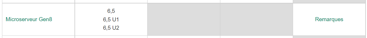

    HI,
    HPE GEN8 servers are not compatible with VMware version 7.0.  You can at most install version 6.5
    So it is normal that you encounter anomalies.
    https://techlibrary.hpe.com/us/en/enterprise/servers/supportmatrix/vmware.aspx

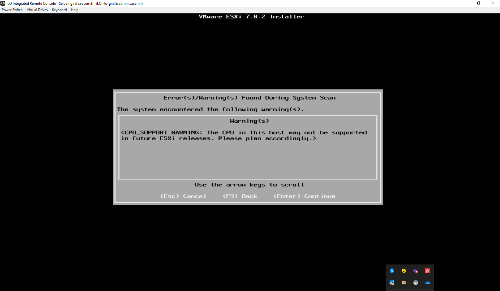

    Otherwise, during the installation of the VMware OS you may have had a warning message of the type:
