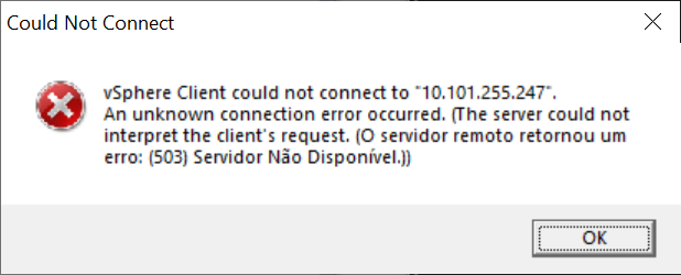

    When I try to login on my vCenter Server Appliance 6.0.0 with VMWare vSphere Client I am getting this error:

    I dint't have problem on this command:
    service-control --stop --all
    But when I do start...
    service-control --start --all
    I get this error:

    And I still get this error on my log:
    vcenter55:/tmp # tail /var/log/vmware/sso/vmware-identity-sts.log
            at com.vmware.identity.saml.impl.TokenLifetimeRemediator.validateSigningCert(TokenLifetimeRemediator.java:92)
            at com.vmware.identity.saml.impl.TokenLifetimeRemediator.remediateTokenValidity(TokenLifetimeRemediator.java:66)
            at com.vmware.identity.saml.impl.TokenAuthorityImpl.issueToken(TokenAuthorityImpl.java:191)
            at com.vmware.identity.saml.impl.TokenAuthorityImplPerformanceDecorator$1.call(TokenAuthorityImplPerformanceDecorator.java:48)
            at com.vmware.identity.saml.impl.TokenAuthorityImplPerformanceDecorator$1.call(TokenAuthorityImplPerformanceDecorator.java:45)
            at com.vmware.identity.performanceSupport.PerformanceDecorator.exec(PerformanceDecorator.java:36)
            at com.vmware.identity.saml.impl.TokenAuthorityImplPerformanceDecorator.issueToken(TokenAuthorityImplPerformanceDecorator.java:45)
            at com.vmware.identity.sts.impl.STSImpl.issueToken(STSImpl.java:342)
            ... 48 more
    [2023-02-13T12:47:05.431Z tomcat-http--24 vsphere.local        3a8ff080-93d6-4453-9bd3-f648ed90b1aa INFO  com.vmware.identity.sts.ws.SOAPFaultHandler] Returning a SOAP Fault with code: ns0:InvalidTimeRange and description: The token authority rejected an issue request for TimePeriod [startTime=Mon Feb 13 12:47:05 UTC 2023, endTime=Mon Feb 13 14:27:05 UTC 2023] :: Signing certificate is not valid at Mon Feb 13 12:47:05 UTC 2023, cert validity: TimePeriod [startTime=Wed Dec 12 16:59:36 UTC 2012, endTime=Sun Dec 11 16:59:36 UTC 2022]
    I don't know what to do.
    What certificate is this it is complaining about? Does anyone know?
    How do I solve that?
    Please, if anyone know, tell me.
  • 2.  RE: The token authority rejected an issue request for TimePeriod
    Broadcom Employee
    Posted Feb 14, 2023 04:16 PM
    VC 6.0 really. These are legacy versions.  STS is indeed expired . I have never used that script to replace STS on 6.0 version. The kB even says for 6.5 and above versions. But looks like the script succeeded .
    Signing certificate is not valid at Mon Feb 13 12:01:36 UTC 2023
    Can you also check vmdird cert if its expired > /usr/lib/vmware-vmdir/share/config/vmdircert.pem
    Also renew SMS certs : https://kb.vmware.com/s/article/2120105

  • 4.  RE: The token authority rejected an issue request for TimePeriod
    Best Answer
    Broadcom Employee
    Posted Feb 20, 2023 07:48 AM
    STS certificate is still expired. That command doesn't pull STS certificate info . I think VMware also pulled down all docs related to 5.x so cannot find any STS replacement docs .
    Better to reinstall VC and get a supported version up .
