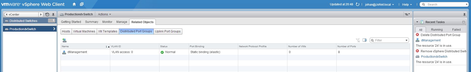

    I have created a dSwitch, and when I am going to delete it and start over I am getting this error:
    The resource '24' is in use.
    vDS ProductiondvSwitch port 24 is reserved by entity esxi1.xyz.local Virtual NIC vmk0, type:hostVmkVnic
    Port 24 is my dManagement Port group.
    When I go to Distributed Switch /.... / Manage / Ports I only see my Port gorups created and its "Blank".
    When I go to the Settings tab. I see that the Switch dont have any NIC on its uplinks.
    I can delete all Port Groups BUT dManagement.
    All NICs stand Unused on dManagement.
    The hosts are disconnected...
    Anyone who can assist me?

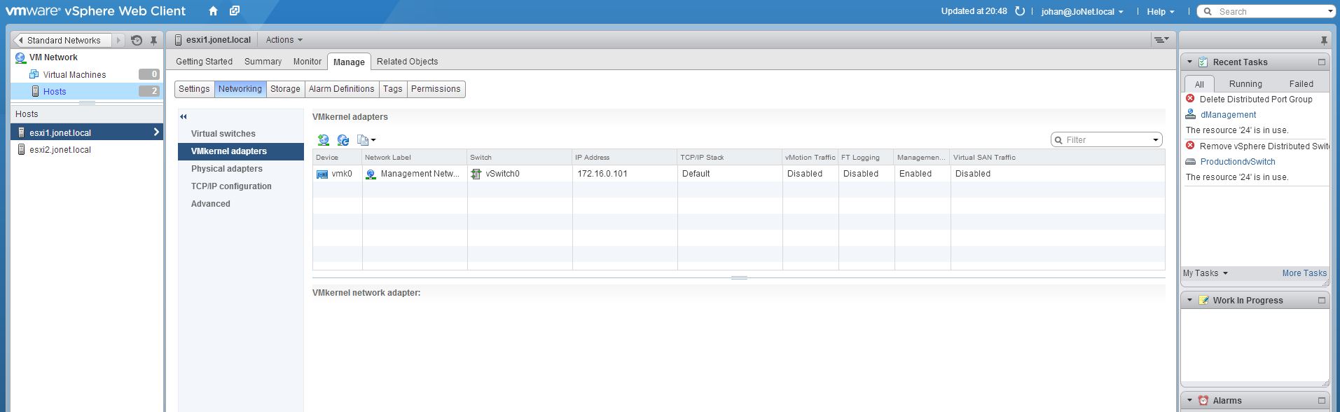

    The vmk0 are still on the distributed switch port group ? If yes, migrate the vmk0 to a standard switch port group.

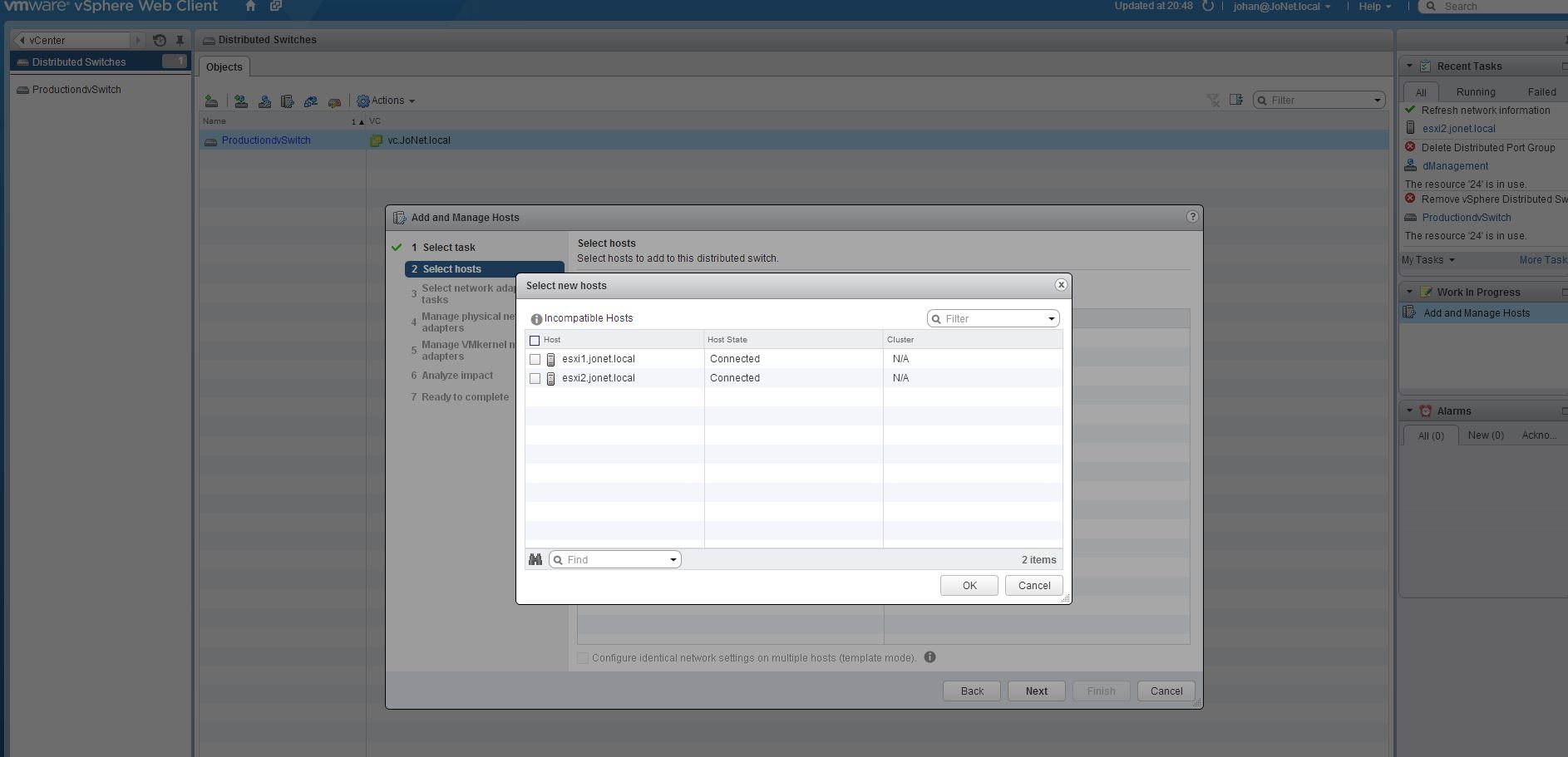

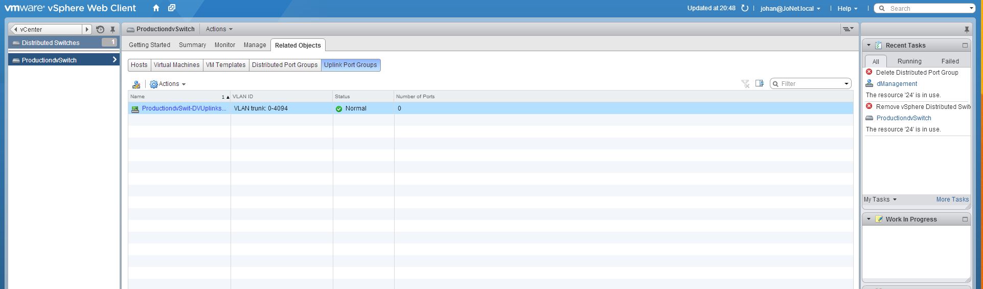

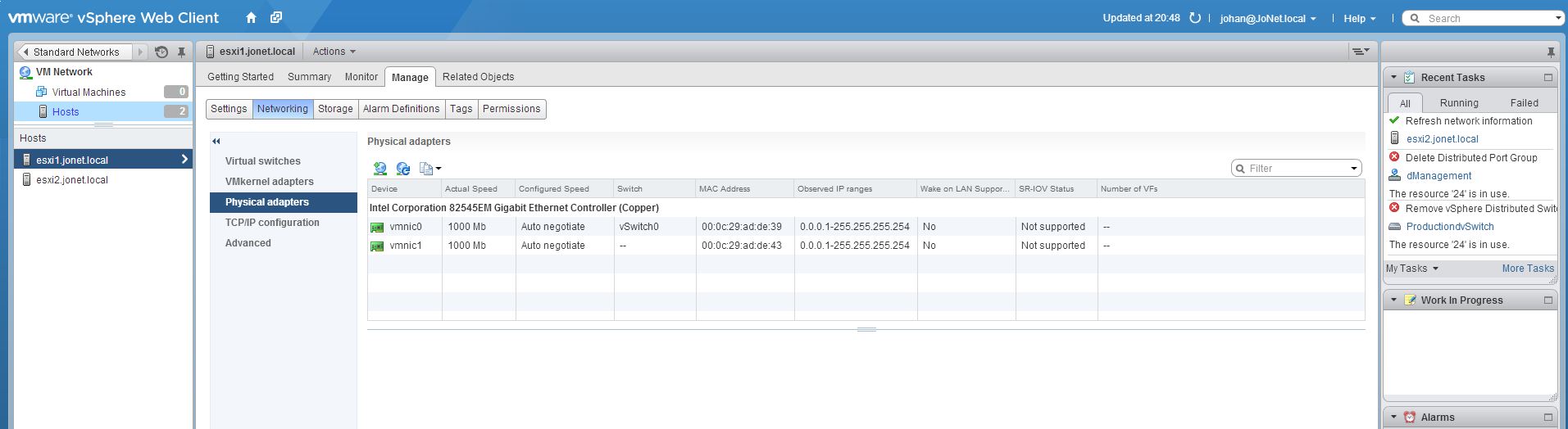

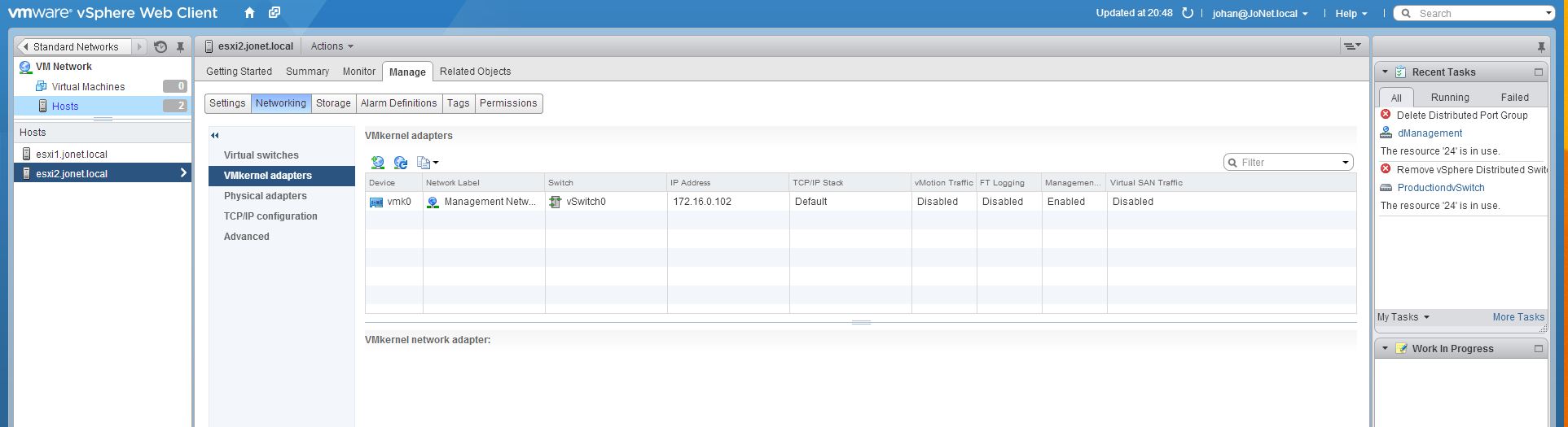

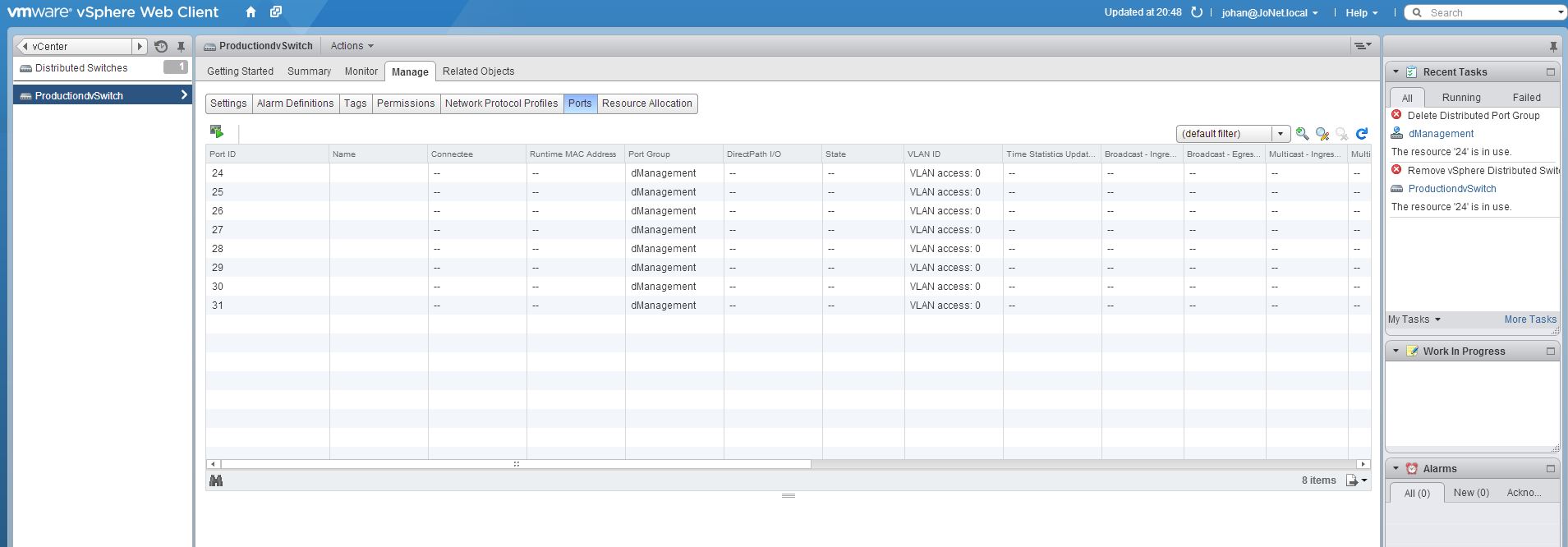

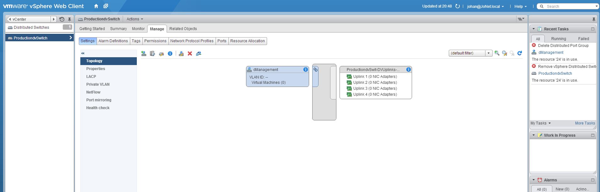

    Adding some images of my configuration. Maybe helps out to find out what I am making wrong.
    I cant see vmk0 on any distributed switch in my setup. If I read it correctly vmk0 is connected to vSwitch1 and not a VDSwitch? (see last images)

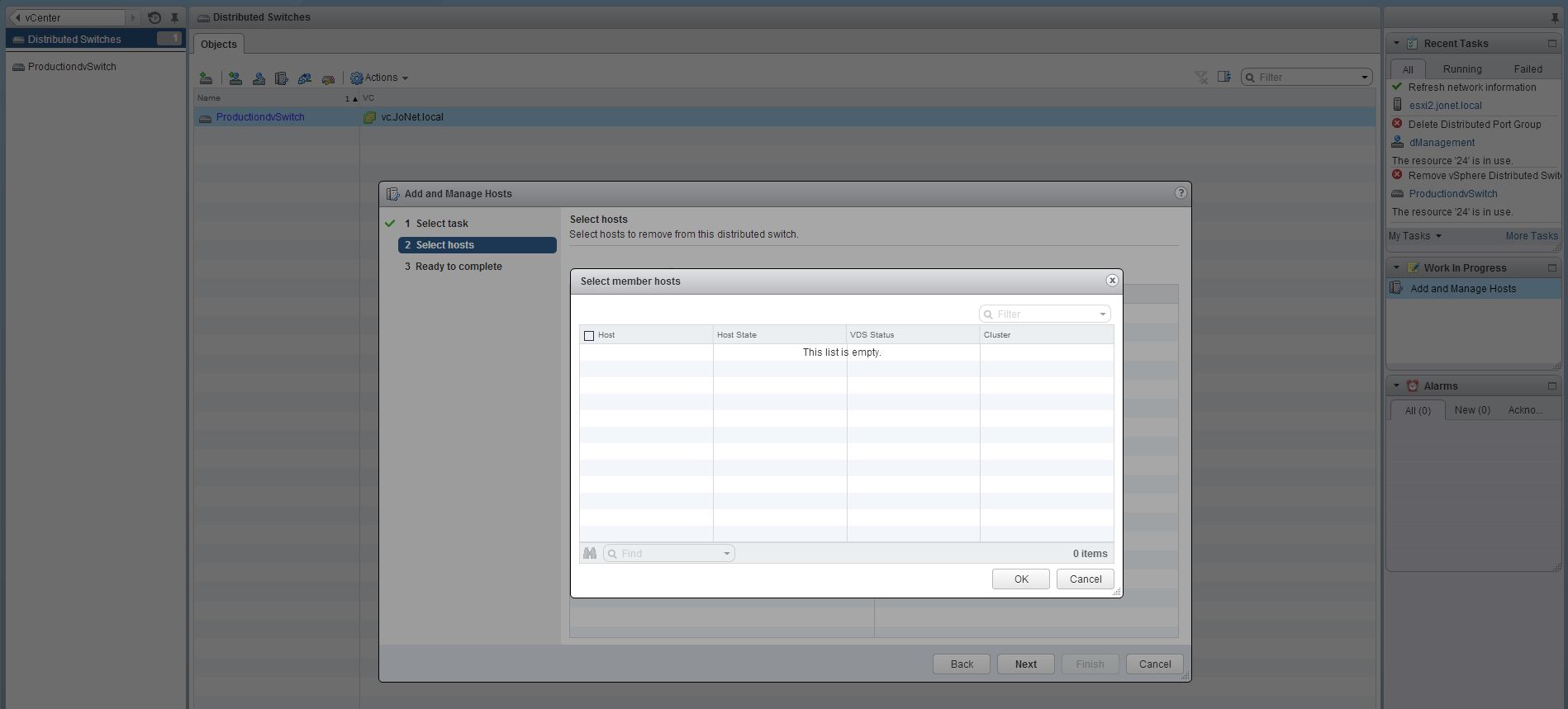

    Try remove the host from Distributed Switch and then delete de vDS.
  • 5.  RE: The resource '24' is in use. But its not?! Cant delete VDSwitch.
    Posted Jun 24, 2014 08:19 PM
    I have tried that. And there is nothing to remove, but I can add the hosts back in if I want to.
