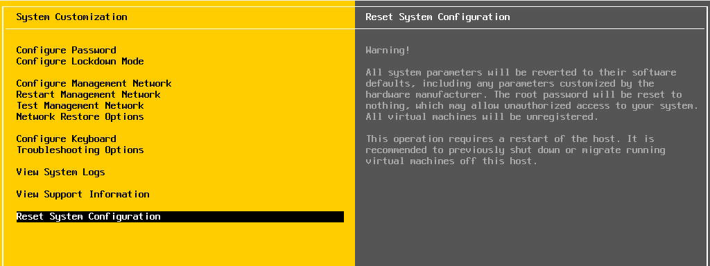

    One of our ESXi 6.7 hosts was reset via "Reset System Configuration" in the course of troubleshooting of a networking issue:
    Once reconfigured back to how it was before, re-connected to vCenter, and re-assigned the same "VMware vSphere 6 Standard" license, the host gets an error, "The host license edition is not compatible with the vCenter Server license edition".
    The host is one of about 20-30 running on the same license, identical hardware, etc., and I am stumped why this may be happening.
    Where would I go to try figure out exactly what's causing this? Any specific events or logs that spell out the root cause?
