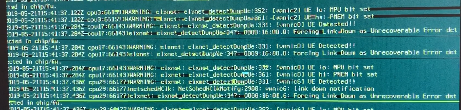

    Couldn't get the logs off because there isn't enough space locally to make another datastore. I did watch the vmkernel.log on the blade directly and saw this, which is a fimware bug, I see a newer version I'll have to try

    Sometimes an older version might do the trick. I saw several other articles on this error.
