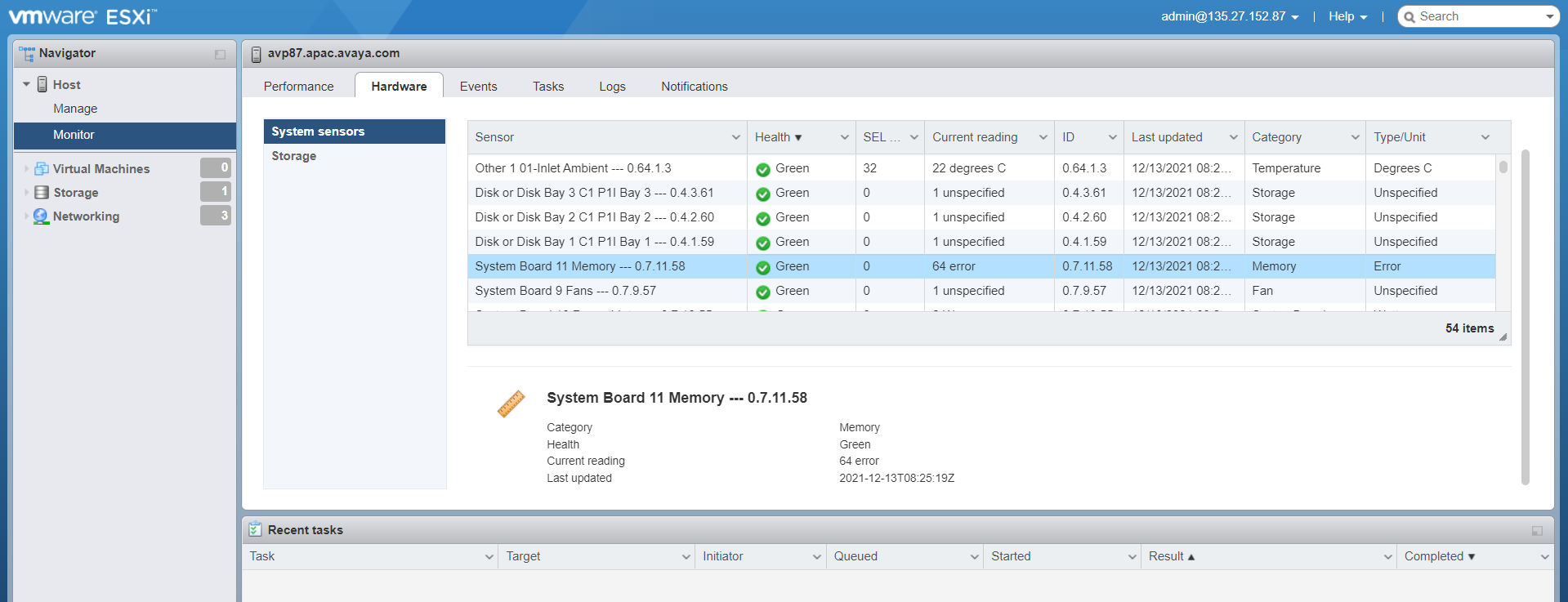

    Hi,
    I am using ESXI 6.5 version, and I am getting this error 64 for system board 11 Memory. The health status shows it is healthy (green), and it is not affecting system. Yet I wanted to know what the error is and how do i resolve this issue. This issue has been seen on atleast 3 HP DL360 Gen8 servers.

    Hello.
    The first thing would be to check in the ILO of each server if there are any hardware errors.
    Did you use the custom image from HPE, when the build was installed?
    It would be reconedable to update the firmware of a server with problems with the latest Service Pack (SPP).
    You should also apply the latest patches to your 6.5 version.
