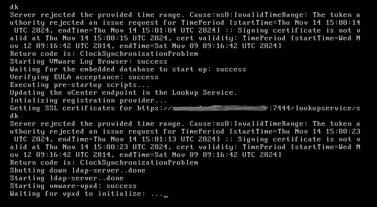

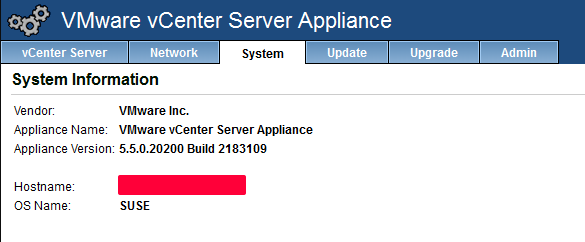

    I currently have an old version of vSphere 5.5 (yes, it's old ;) ) that is in the process of being migrated to the latest version.
    The problem is that since this morning, I haven't been able to connect with the vSphere client or the web client. It seems to be an issue with the STS certificate, which has expired. After a lot of research and a few attempts, I haven't been able to get the vSphere server working again, and all the documentation I found is for version 6.x :( Do you have any suggestions to at least get it working until the end of the year?
    The error is the same as on this page :
    ERROR com.vmware.vim.sso.client.impl.SecurityTokenServiceImpl$RequestResponseProcessor opId=] Server rejected the provided time range. Cause:ns0:InvalidTimeRange: The token authority rejected an issue request for TimePeriod [startTime=Date MM DD:TT:SS EST YYYY, endTime=Date MM DD:TT:SS EST YYYY] :: Signing certificate is not valid at Date MM DD:TT:SS EST YYYY, cert validity: TimePeriod [startTime=Date MM DD:TT:SS EST YYYY, endTime=Date MM DD:TT:SS EST YYYY]
    Thank you in advance.

    thank you for your response. I tried this solution, but whether the allow_regeneration file is empty or contains the value only-once, unfortunately, I get the same error upon restart and no new certificates are generated :(

    In the comments, it was suggested to move the certificates, but even doing that, no new certificates are generated.
