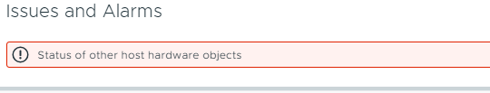

    Hi Guys,
    I got an error message at vCenter 7.0 on ESXi host on Lenovo SR 950.Facing very frequently. Friends solution plz

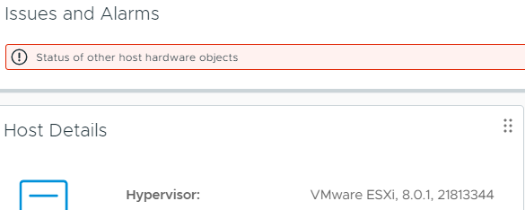

    Very Frequently in all hosts faced the issue
    Upgraded one of the esxi host from 7 to 8, now the issue resolved whether this is correct or wrong don't know but my problem is solved.

    Even after upgrading host from Esxi 7 to Esxi 8  facing same issue again. Team, Could you plz help me on this.

    Alarm 'Status of other host hardware objects': an SNMP trap for entity  was sent
    Solution Plz  frnds
