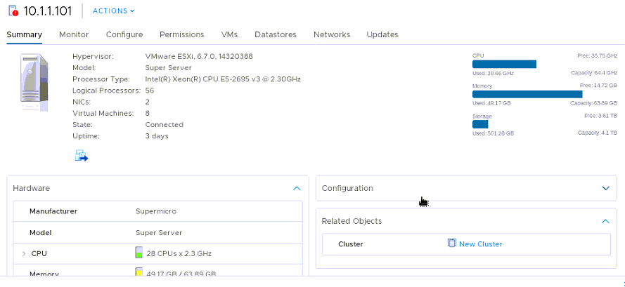

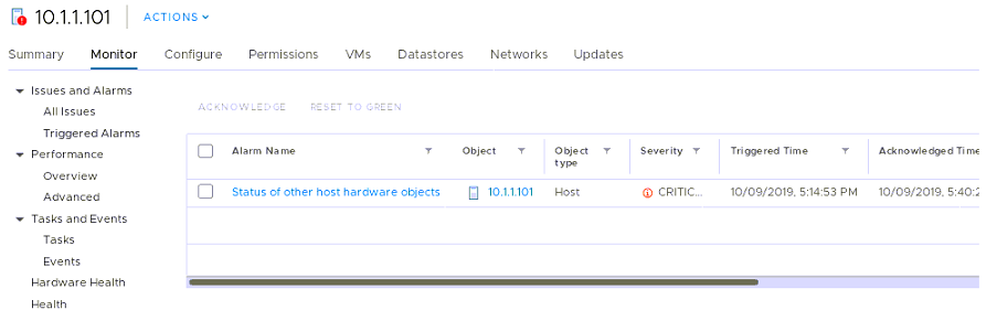

    As I check the node->monitor->triggered alarms, I see "status of other host hardware objects" in a critical state. When I click on it, it goes to the summary page and nothing weird is there.  As you can see in the picture, the red circle is in the node's icon but there is no bad message in the summary page.
    How can I find out more?

    Hi mahmn,
    It looks like that is an old alarm warning that has been acknowledged but not reset to green.
    Select the item and click the “Reset to Green” option which will then become available. This will remove the alarm and set the object to healthy.
    Kind regards.
  • 3.  RE: status of other host hardware objects
    Posted Dec 27, 2020 06:56 AM
    The time of trigger is a little old, reset it to green and if it happened again, check the current logs and health status of this physical server via vendor OOB/LOM solution. (Like iLO for HP Proliant server)

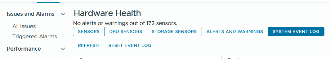

  • 9.  RE: status of other host hardware objects
    Posted Jul 01, 2025 06:49 AM
    Just Reset the System event logs for the subjected server.
