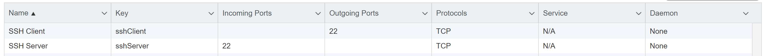

    I did enable ssh client on host machine, and restarted the vm guest

    I tried SSH from a Windows 10 VM to the host it was running on and it all worked fine. That was using the built in SSH client.
    I think I would be verifying the firewall settings for the SSH client application both inbound and outbound.
