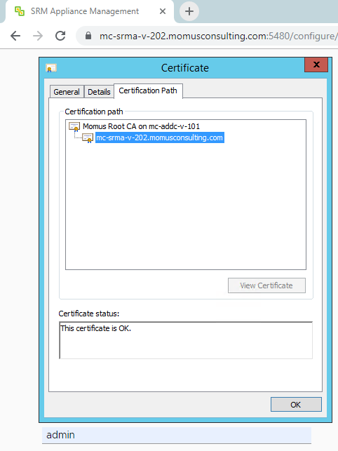

    Does anyone know how/where to change the SRM & vSphere Replication 8.2 Appliance VAMI https certificates?
    I have updated the main appliance certificates, with ones signed by my Enterprise CA, but I cannot find there they are updated for the VAMI interface?

    SRM appliance VAMI uses the main appliance certificate. You may need to reload your browser after changing the certificate.

    Thank you Daniel,
    I am not sure what happened initially, as I did refresh my browser(s). It seems to be working now that I have restarted both the SRM & vSphere Replication appliances.

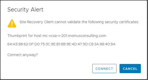

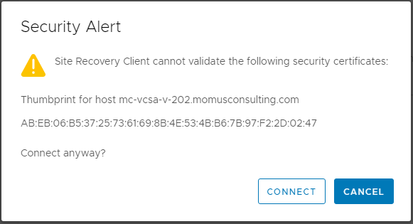

    I am still have a niggly issue with SRM when pairing sites, where the one site cannot validate the vCenter server certificate on the other site.
    Steps I have taken:

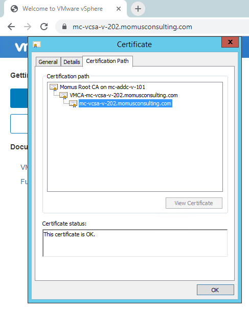

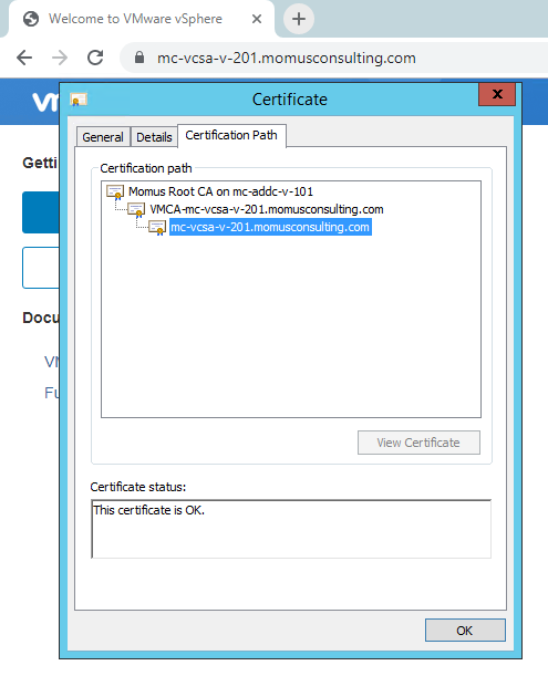

    1) I have reconfigured both of my vCenter server's VMCA's to be subordinate to my Enterprise CA, Both completed successfully and I can browse to either vCenter server without getting browser security errors.

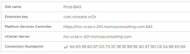

    2) I have added my Root CA and both vCenter VMCA CA certificates to the both SRM appliances & re-run c_rehash (without error). They now have trusted connection thumbprints - the same thumbprints as the SRM site pairing does NOT trust!
    3) I have created CSR's, signed them (with my root CA) and installed PKCS #12 certificates for both SRM appliances. I restarted both appliances and I can browse to them without getting a browser security error.
    Do my vCenter Servers need each others VMCA CA certificate importing? Just tried this and it still errors.
    I do not have any SSO/ELM between vCenter servers?
    I need a sanity check, can you see/think what have I missed?

    Thank you again Daniel,
    That has worked. I can now deploy both SRM and vSphere Replication appliances with certificates that are signed by my Enterprise CA.
    I can also import the Root CA and both VMCA subordinate CA certificates into each appliance, so there are no more trust warning messages when pairing sites/etc.

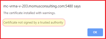

  • 8.  RE: SRM & vSphere Replication 8.2 Appliance VAMI - How to change the HTTPS Certificate
    Posted Mar 25, 2020 08:38 AM
    Hi M,
    Where did you generate the CSR request for the replication appliance?
    I have followed the procedure from Daniel and have successfully created and installed the certs on both SRM appliances, however I don't see any option to generate a CSR on the replication appliance.
