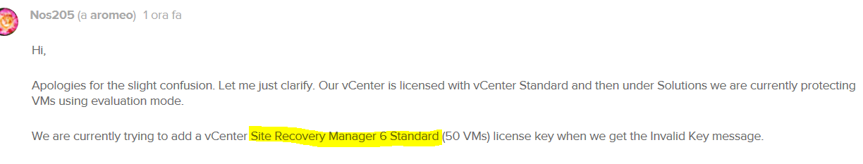

    Hi,
    Apologies for the slight confusion. Let me just clarify. Our vCenter is licensed with vCenter Standard and then under Solutions we are currently protecting VMs using evaluation mode.
    We are currently trying to add a vCenter Site Recovery Manager 6 Standard (50 VMs) license key when we get the Invalid Key message.

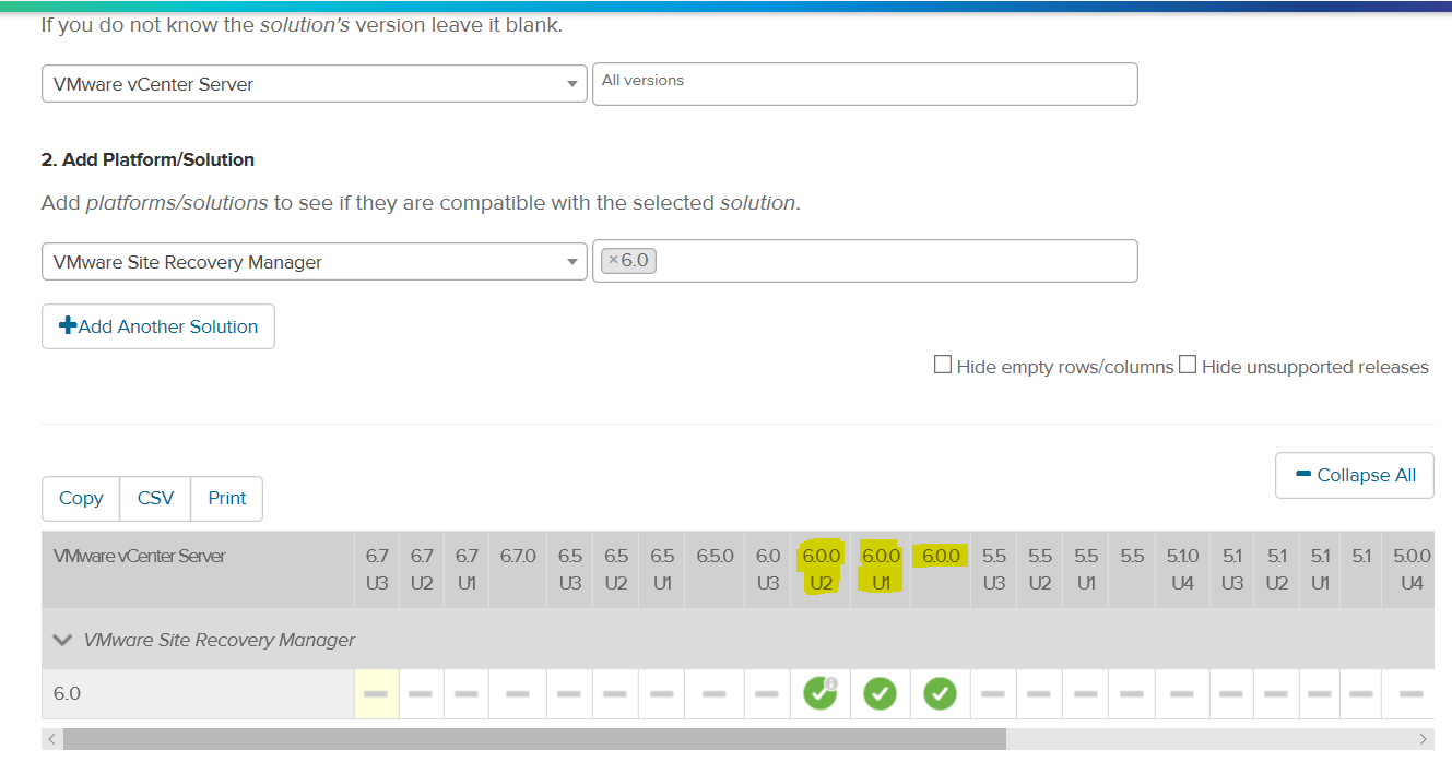

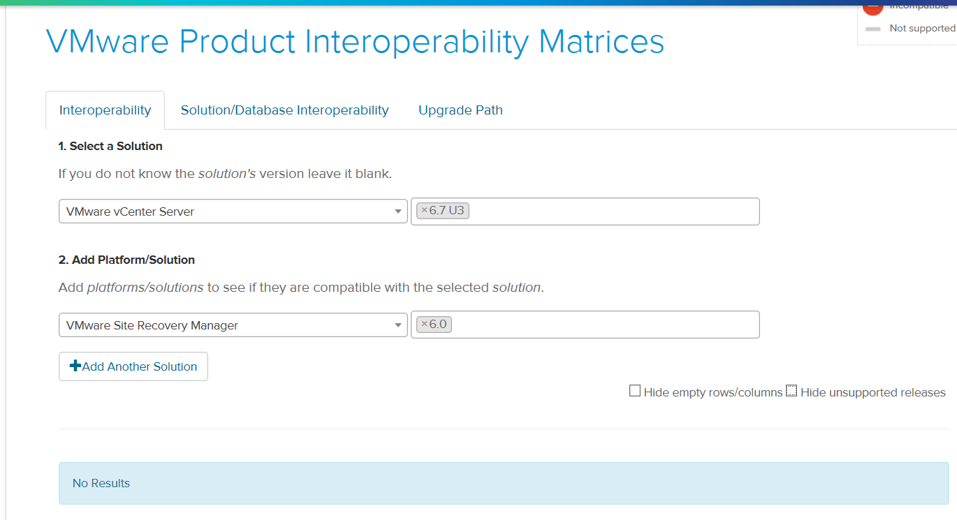

    I think the problem is that the two products are not compatible. According to the VMware compatibility table, SRM 6.0 is not compatible with vCenter 6.7u3. For this reason, the license cannot be registered.
    VMware Product Interoperability Matrices
    Your SRM license is fine are for these versions of vCenter:
    ARomeo

    Hi, Just confirm. We are using SRM 8.2 with vCenter 6.7 U3
  • 8.  RE: SRM License Key Invalid
    Posted Feb 21, 2020 07:44 PM
    Sorry but what did you write here:
  • 9.  RE: SRM License Key Invalid
    Posted Feb 21, 2020 07:49 PM
    Hi, so yes. Was using SRM 6 Standard license. That's not going to work is it? We need to request SRM 8 license?
    Thanks
  • 10.  RE: SRM License Key Invalid
    Best Answer
    Posted Feb 21, 2020 07:52 PM
    Yes

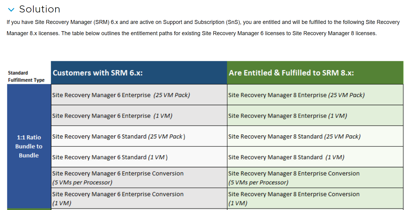

    Additionally, I read this. However, are there different licenses for SRM 8.x? Can we not use a version 6 license?
