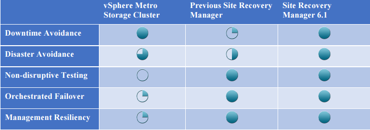

    From what I read in this SRM Whitepaper for version 6.1, I can have best of both worlds by configuring SRM with stretched storage.

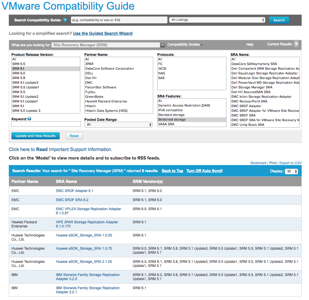

    Stretched storage integration with SRM requires specific storage from your array vendor that supports not just synchronous replication, but also the ability to present the same LUN/datastore to both sites/arrays as read-write at the same time AND an SRA that will work with that array and SRM 6.1 or later.
    For details on stretched storage in the SRM documentation see here: Site Recovery Manager 6.1 Documentation Center
    For compatibility information see: VMware Compatibility Guide - sra
    Note that there is a filter option for stretched storage. When I search for IBM and SRM 6.1 w/Stretched storage I see the Storwize SRA ver 3.2 and 3.2.1.

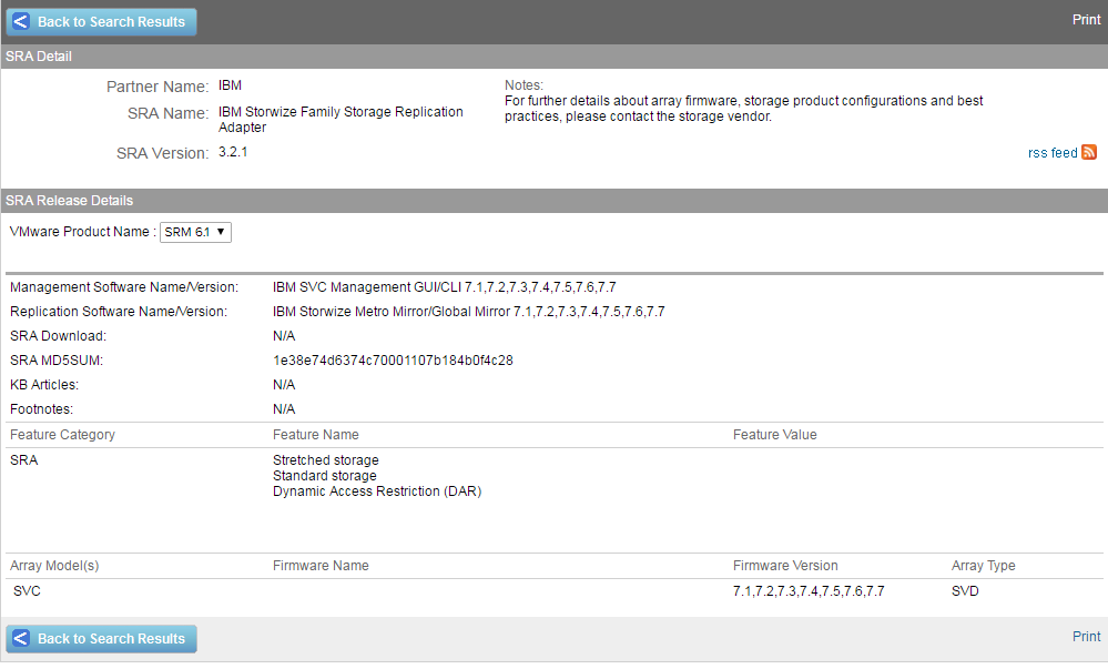

    SRA ver 3.2.1 for Storwize is already what we are using for ABR with SRM 6.1.
    How do I know if stretched storage integration is also supported with an hyperswap volume.  When looking at the search results in the compatibility guide, I only see Array Model(s) : SVC
    Thanks again for your help!

    That would be a question for IBM. The SRA documentation might help?

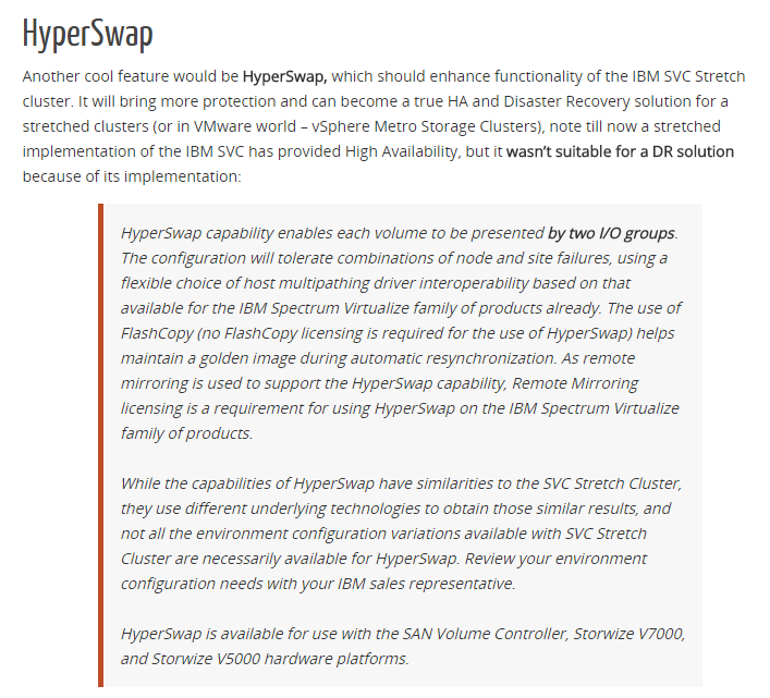

    From IBM : "There is no SRM type plugin for HyperSwap at all since, HyperSwap circumvents the need of such a plugin. It is the solution to get rid of the expensive solution with VMware Site Recovery Manager. Same is valid for any other supported host type with HyperSwap, like Windows with Hyper-V."
    Thanks!
  • 6.  RE: SRM 6.1 vs Stretched Cluster (vMSC)
    Broadcom Employee
    Posted Mar 30, 2017 05:25 PM
    Kind of strange that IBM would say that after being one of the vendors that has an SRA that supports this and has publicized it: Considering "VMware SRM stretch" ?? – Think IBM San Volume Controller (SVC) - Storage ISV Blog - Storage ISV
    It sounds like they are pushing vMSC over SRM integration so I would recommend you look into the differences.
    For HyperSwap have them explain to you how would:
    - Non-disruptively test a failover
    - Orchestrate a disaster avoidance scenario
    - Run scripts or have callouts as part of a recovery plan

    I guess it comes down to Hyperswap vs SVC ..
    From what I understand, SVC is a more robust and expensive solution.

    We already have SRM and it's been working well for us.  We use the SRM Test feature quite a bit.  A stretched cluster doesn't give us the ability to test a failover in the way that we need it to.
    Being able to use cross-vCenter vMotion with stretched storage and have SRM at the same time for orchestrated DR is what we thought we could achieve with Hyperswap.  From what I understand, SVC can do this but not Hyperswap.
    I'm not against a stretched cluster down the road.  But for now, SRM is in place and we don't have all the compute power at the remote site for a stretched cluster.  Stretched cluster also means double the storage which we don't have at the moment.
    Like @gs_khalsa says, a stretched cluster doesn't give me :
