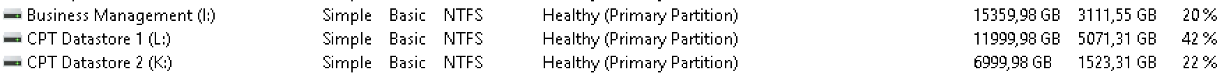

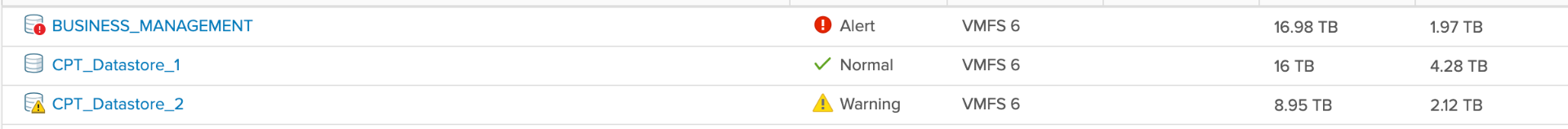

    I have a weird issue, My host is saying I am using more space than what's shown inside the VM. I have 3 VMDKs connected to the same host and these VMDKs are from a single SAN. The sizes of each disk from the SAN are 9TB, 16TB and 17TB, usage according to VMWare is 7TB, 12TB and 15TB respectively. Account to the host usage is 5TB, 6TB and 12TB respectively.

    I've attached a picture of the 3 volumes in question. The other command just shows the total size of the disks attached the host and I have no issues with the rest of the disks, just these 3.

    These are the drives in question, I haven't fully used the available storage from the VMFS volume but the data usage doesn't match with what is used on the drive.

    Alright. Comparing the output from df -h and the datastore usage summary from Web client, they seem to be matching. Please compare the following:
    VM storage usage on VM summary
    Navigate to Datastore/VM folder from SSH and run du -sh to list the actual usage
