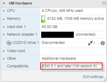

    Posted May 29, 2017 01:34 PM
    Big V
    Thanks for your time, I have checked all VM are they are Version 9, the ones that I can Vmotion as well as the one that I can't, now I guess I got the right information, the version is the one that accompanies the compatibility
