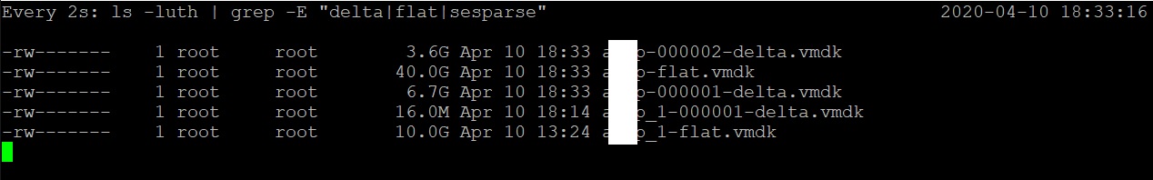

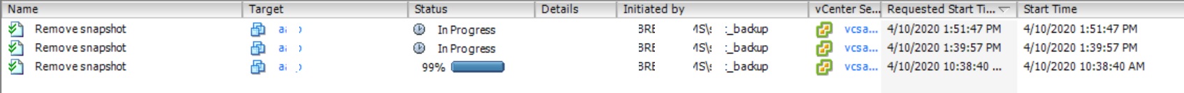

    One of the VMs (which is part of the Veeam backup) is stuck removing snapshot at 99% for several hours. We canceled Veeam backup job and noticed 2 more snapshot removal jobs with no progress.
    -000001-delta.vmdk has been stuck at 6.7GB for several hours, however we are seeing slow groth on -0000002-delta.vmdk

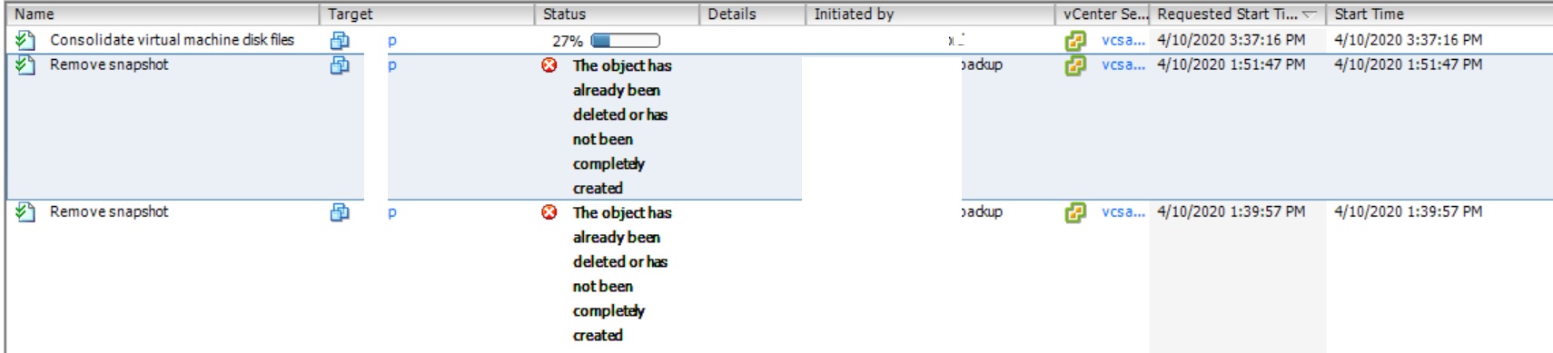

    Snapshot removal jobs eventually timed out (I didn't cancel the task) and I was left with a VM that needed to be consolidated
