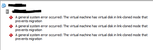

    None of the above has worked.  When i sVmotioned the VM to another datastore I selected the option to provision the .vmdk's as thin but when checking after the sVmotion it's still showing as thick.  When attempting to sVmotion with the VM powered on I recevie the following error message:
    Anyone has any other suggestions?

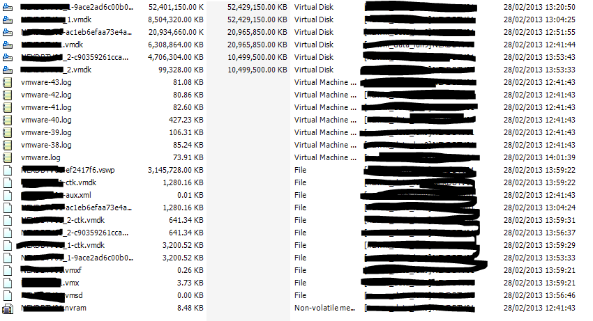

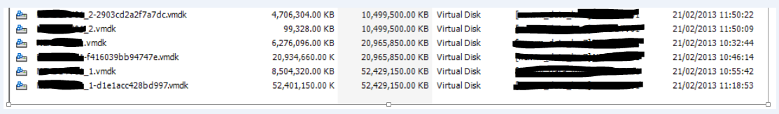

    Thanks for the reply.  I actually dont think any snapshots exist as I can sVmotion and there are no delta files in the directory.  I think the snapshot alarm is a red herring:
    What's confusing me is the 3 VMDK files with the -XXXXXXXXXXXXXXXXXX
    The VM is using the base disks rather than the -XXXXXXXXXXXXXXX disks but I'm not to sure if I can just delete these disks

    Because the files have current time stamps, it looks like they are indeed in use. I'd recommend you take a look at the VM's latest vmware.log to see whether these files show up there.

    @ André - I think the timestamps are showing current as this was when the sVmotion was performed.  I'll check the log files and report back
