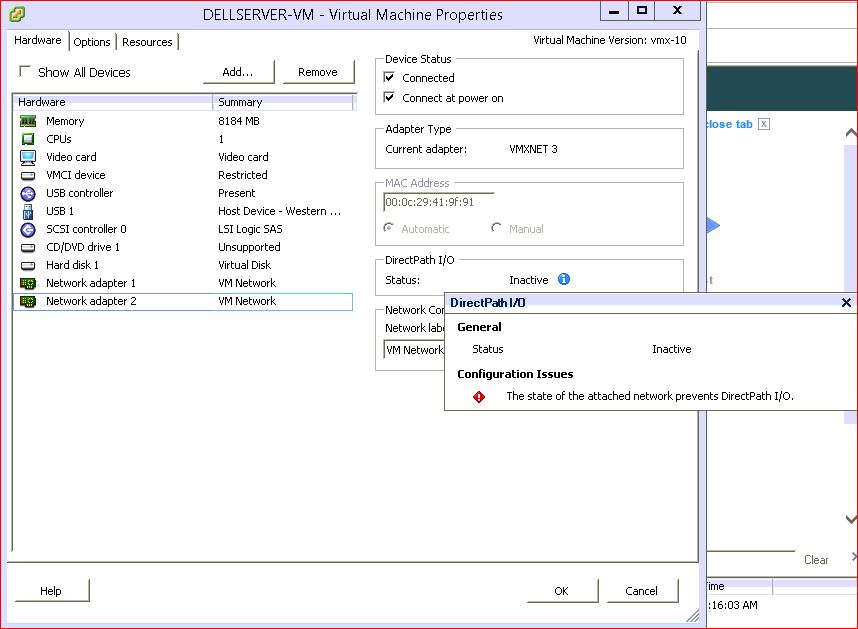

    Both VMs are on same physical host and both are using the same vmnic0.  I added the VMXNET 3 adapter to the slow VM and removed/disabled the E1000 adapter but it's Internet speed is still much slower than the other VM.  The VMXNET 3 adapter shows it's connected at 10GB/s.
    I did notice in vSphere settings for the VMXNET 3 adapter that it said the DirectPath I/O is Inactive and that I need to select Resources tab and to reserve all the guest memory, which I did.  However, it still shows DirectPath I/O as Inactive with message that "The state of the attached network prevents DirectPath I/O."  See attached screenshot.
    Any further ideas?  The slow vm is Windows SBS 2011 and the fast vm is Windows Server 2012 R2.  Could guest OS be the issue?  I don't think so, ya?
