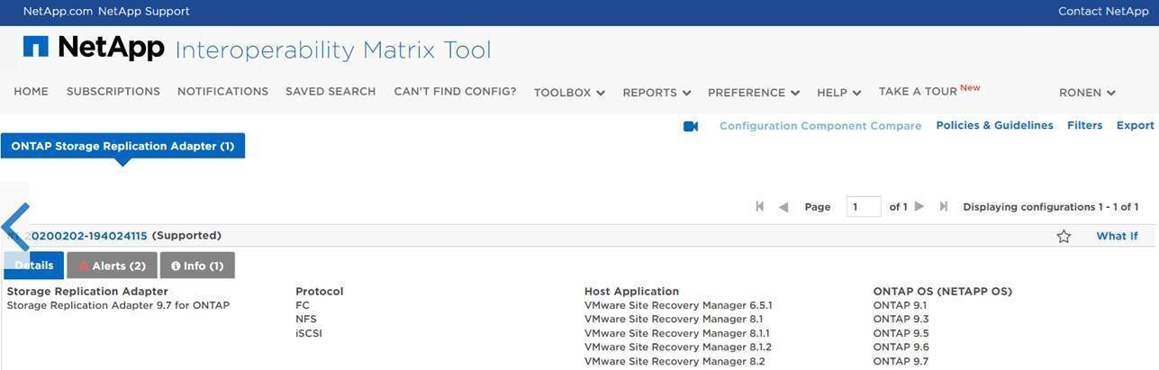

    I want to use SRM 8.2 (on NFS) with NetApp ONTAP 9.7.
    According to NetApp, Using SRM 8.2 with Storage Replication Adapter (SRA) 9.7, is a valid configuration:
    https://mysupport.netapp.com/matrix/imt.jsp?components=92365;&solution=576&isHWU#results

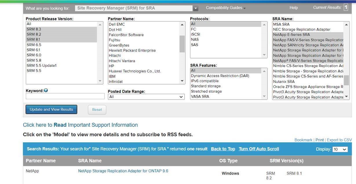

    However on the VMware side, only ONTAP 9.6 is supported with SRM 8.2:
    https://www.vmware.com/resources/compatibility/search.php?
    deviceCategory=sra&details=1&srmVer=507,466,416&partner=64&releases=507,466,416&sraName=32,23,167,126,289,85&page=1&display_interval=10&sortColumn=Partner&sortOrder=Asc
    Also, on the SRA download page, I could only find NetApp_Storage_Replication_Adapter_ONTAPA_version9.6.zip
    which is for ONTAP 9.6.
    https://my.vmware.com/group/vmware/downloads/details?downloadGroup=SRM_SRA82&productId=889
    Is there a SRA 9.7 version for NetApp?
    Which is right, NetApp or VMware?

    If this is a new SRA, it will take some time before it's updated on VMware portal. If Netapp has confirmed that the SRA 9.7 is compatible with SRM 8.2, then that should be good.
  • 9.  RE: Site Recovery Manager 8.2.0 with NetApp ONTAP 9.7
    Posted Jul 20, 2020 03:38 AM
    The problem is that the 9.7 version of SRA is unavailable on the my.vmware.com
    website. The only version available for download is 9.6.
    Regards,
    Ron.
