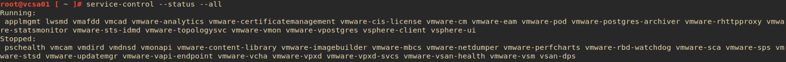

    So I ran into an issue where the datastore my VCSA (6.7 U2a) sat on ran out of space which caused all sorts of issues. Fortunately I was able to free up some space but since then I haven't been able to get into the VCSA UI, I can access the VAMI but that's it...
    I checked the services and can see most of them haven't started
    So I attempted to start VMware-vpxd but unfortunately it just fails with the error:

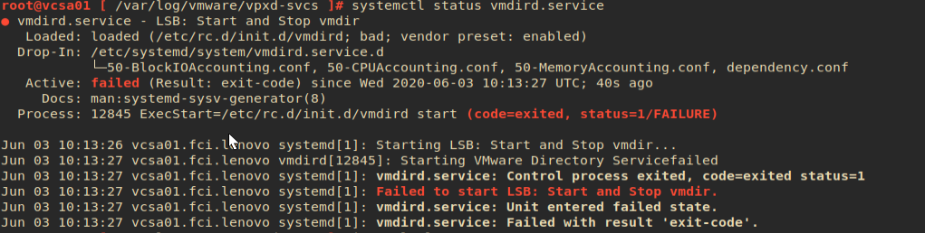

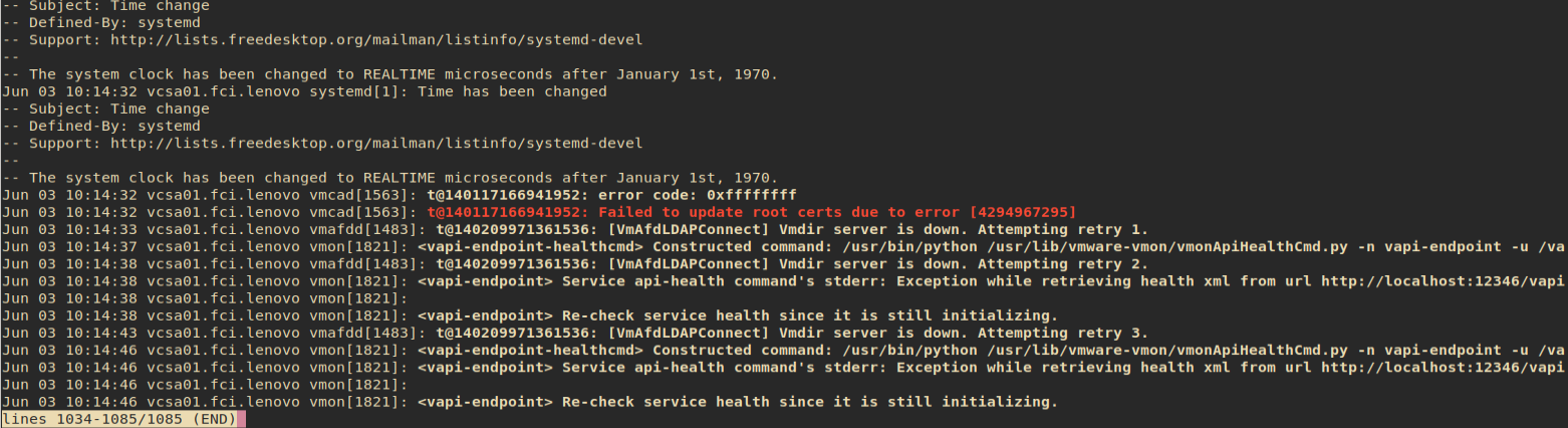

    In the vpxd-svcs log I noticed an error stating it couldn't access the LDAP server so I checked and confirmed vmdird is currently stopped. I tried to start this but it failed im seeing these errors now:
    Does anyone have any suggestions on how to fix this? :smileyconfused:

    You should review this log then to look for some erros: /var/log/vmware/vmdird/vmdird-syslog.log.
    You will definitely find some interesting error logs lines there.

    There are other dependent services like vapi-endpoint, vpxd-svcs etc also faied to start. so vpxd would not start
    we need to check the vapi/endpoint/endpoint.log and vpxd-svcs.log on vcsa

    Need to check  /var/log/vmware/vmdird/vmdird-syslog.log. to check more details on the error
