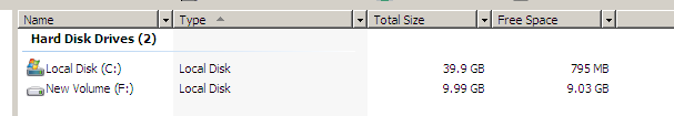

    I have the following issue on both Server 2008 and Server 2008 R2 (has not happened on Server 2003 or 2012 yet) VM's where C:\ drive space is not properly seen by the VM until after a reboot. The drive is Thin Provisioned. After a reboot the server properly sees all the drive space again and is fine for a few weeks to a month but then randomly this will happen again. As you can see in the screenshots below Windows Explorer and Disk Management both report the C:\ as only having 795MB remaining but WinDirStat reports there should be 15.8GB. After reboot the full 15.8GB is reported correctly.
    Any ideas?
    Incorrectly displaying drive space:
    WinDirStat's results of the drive scan:
    Disk Management View:

    Thanks for the reply but, nothing is actually consuming the space which is the problem. TreeSize also displays the same information as WinDirStat, where there is 15.8GB free but Windows Explorer shows only 795MB of space, that is until I reboot the server and then W.E. displays the correct space information.

    Thanks a.p that sounds similar to my issue but this is Server 2008R2 and Server 2008, not Windows 8. There is no search folders so this isn't exactly what's happening. I'm leaning towards this being a VMware issue as it appears Windows is not being presented with the full allocation of the thin provisioned drive space. Nothing is consuming the space as you can see in the initial screenshots since a reboot fixes and refreshes the drive information to the correct consumed amount.
