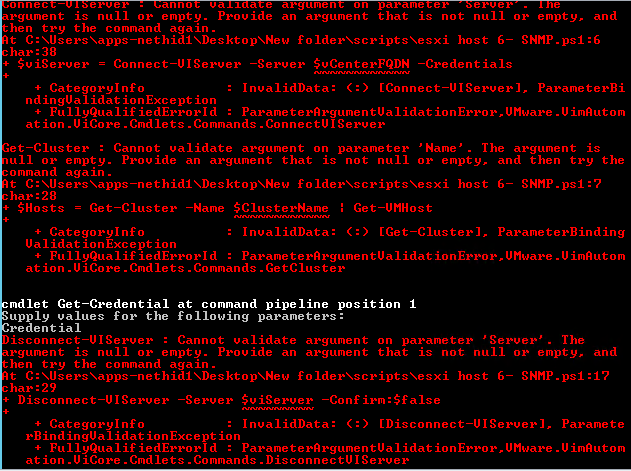

  • 8.  RE: Script to get esxi syslog location across vCenter
    Posted Oct 13, 2017 11:38 AM
    From the error message it looks like $vcenterFQDN is empty, but the script you included doesn't have that variable.

  • 10.  RE: Script to get esxi syslog location across vCenter
    Posted Oct 16, 2017 04:34 AM
    The error messages you included do not seem to correspond with the script you included.
    Can you include the correct code, or the correct error messages?

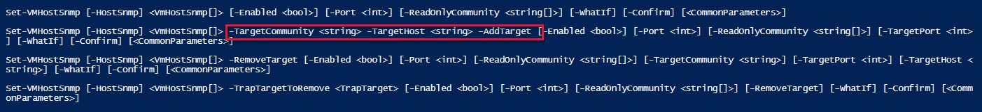

  • 15.  RE: Script to get esxi syslog location across vCenter
    Posted Oct 16, 2017 11:38 AM
    The Set-VMHostSnmp cmdlet has 4 different parameter sets.
    The one that was picked has a number of required parameters, and you have to specify all of them.
    The script becomes
    $esx_list = Get-Content -Path "C:\scritp\servers.txt"
    foreach ($item in $esx_list) {
        Connect-VIServer -Server $item -User root -Password "password"
        Get-VMHostSnmp | Set-VMHostSnmp -Enabled:$true -TargetCommunity "Name" -TargetHost "xxxxx" -AddTarget
        Disconnect-VIServer -Server $item -Confirm:$false
