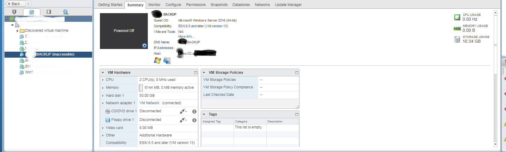

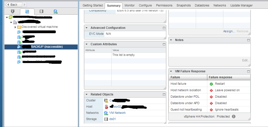

    That's the VM summary.

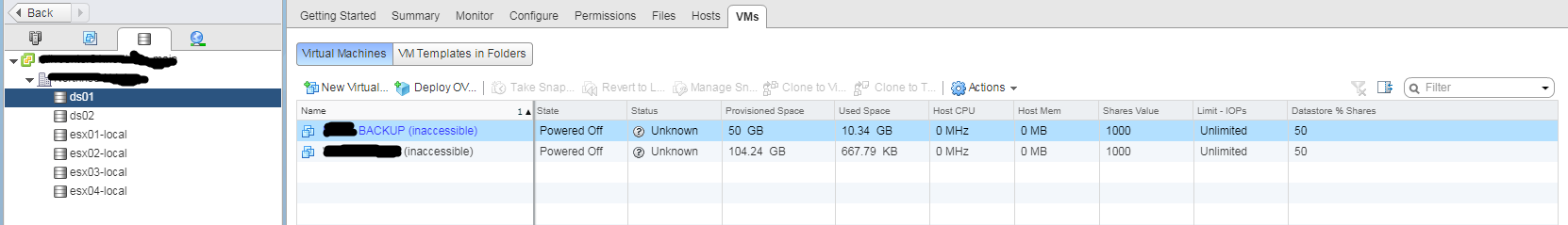

    That's the datastore's list of related VMs. The first one is the one I'm trying to restore.

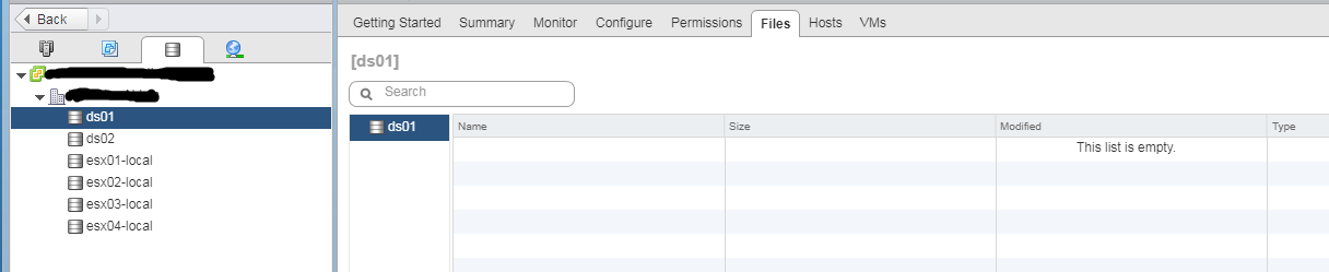

    I'm not sure why there are no files. I was expecting to see some since there are some related VMs.

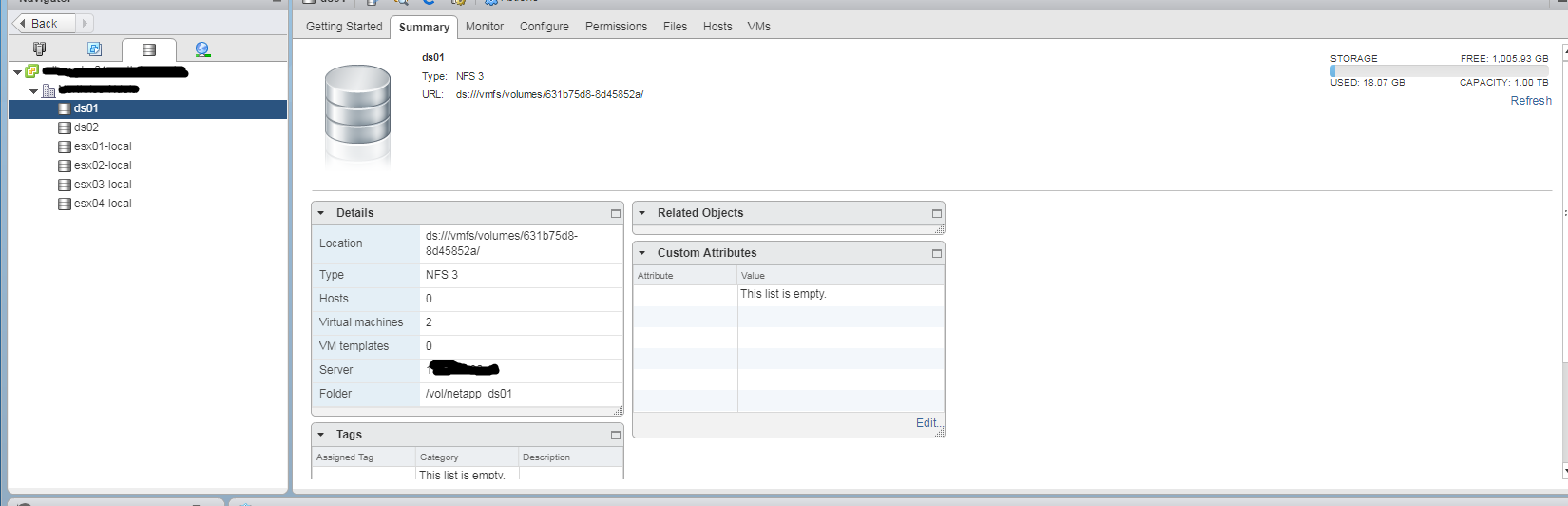

    That's the datastore summary.
  • 3.  RE: Restoring an Inaccessible VM
    Posted Jul 16, 2019 03:13 PM
    The datastore summary says  0 hosts and there are no files seen in the DS.  Do you know what was used space in the DS before the issue ? because now I see the datastore is almost empty.
